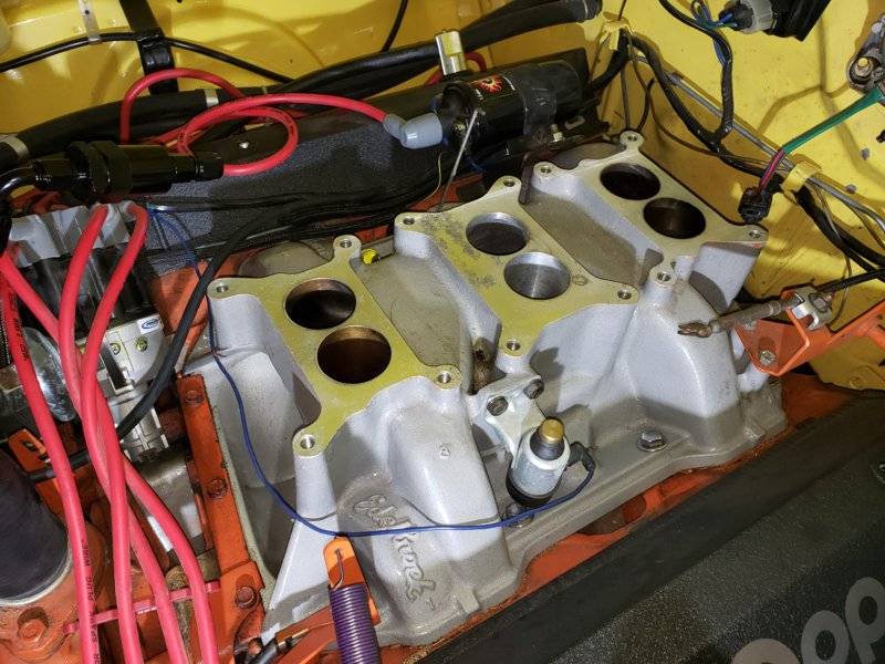

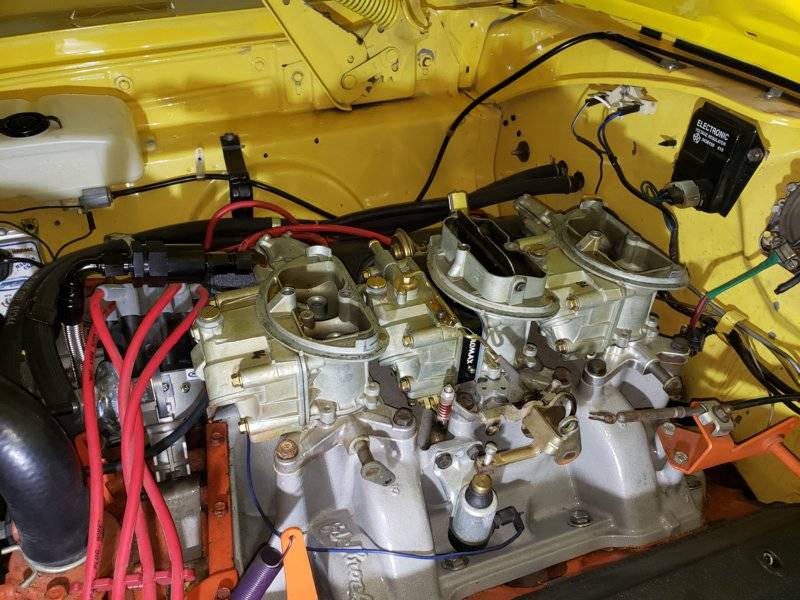

I sent my 3 Holley 2bbl carbs to Promax.
Including their upper and lower fuel lines, I spent $750 in parts.
$400 in labor including tuning on their dyno mule and shipping.
So that's $1,150!
For 2x that amount I could have had the FiTech 3x2 system, good to 650HP.
That doesn't count what I could get for 3 functional running Holley 6pack carbs!
Installing the Promax modded Holley carbs today. Promax mods were for easier/more flexible tuning-which the FiTech would do on its own.

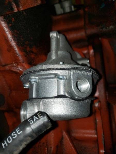

I haven't found a way to do EFI on the really cheap side yet. Setting up the EFI fuel system for me was the hard part. I originally used a sump kit in the stock tank and the external EFI pump, but later converter to an in-tank EFI pump. Really, if you have the ability to weld a sump kit on, you likely have the ability to modify a fuel tank for the in-tank pump. For many of our cars Tanks Inc and Spectra now offer EFI tanks making the conversion easier.
After setting up the fuel system, flush the fuel lines before connecting them to the EFI unit or fuel rail to make sure no trash is in the lines.
All my cars are running a return fuel line, and I connected the supply and return lines together with an old Summit Filter. Then ran the EFI pump for a minute to flush the lines. Reconnected the lines to the EFI, and inspected the filter element inside the Summit filter. I did find a small piece of rubber from the fuel line in the filter. If I did not flush the lines that debris could have gotten into an injector or regulator and cause problems that many would complain is the fault of the EFI, when it really was a install problem.

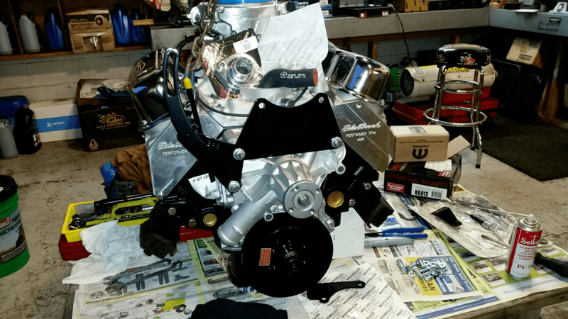

Hi everyone, I’m looking for some insight and views. I have a Mopar performance crate motor, it’s the 410 six pack model P5153227. It’s a 500hp engine. After buying the motor I can’t afford the $3500 for a six pack assembly. So I’m looking at the Holley Sniper. Is this a wise move?
You’ll like it. Easy hook up and let it self learn as you drive. Then if you want, it can be tuned.
Wise move, it’s better in every way other than visual aesthetics. Holley is building a six-pack Sniper EFI assembly as well, unsure of the release date. They filed for the trademark last year.

I just got my Promax modded Holley 3 2bbl carbs back yesterday. Installing them, the Carter M6903, and Promax upper and lower fuel lines now.
Thanks for the input everyone. I’m going to look online for the Sniper. As much as I want a six pack on there, I just can’t justify the outlay. So the Sniper makes much more sense in that respect.
Sure, no point in spending $3500 for three carbs and an intake when you can do an entire Sniper + HyperSpark conversion for less than that. You'll need a good single plane intake, a Holley Super Sniper 650, new gas tank with internal pump, return fuel line and a Hyperspark distributor. Total cost for everything should be around $2500 so you'll save $1000.
