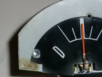

often the electric connection between the el surface and the wiring connector is broken/ loose. you can fix that with conductive silver and a layer of 2k glue. i repaired some of my gauges in this way and fixed all the connections to el surface just for safety.
