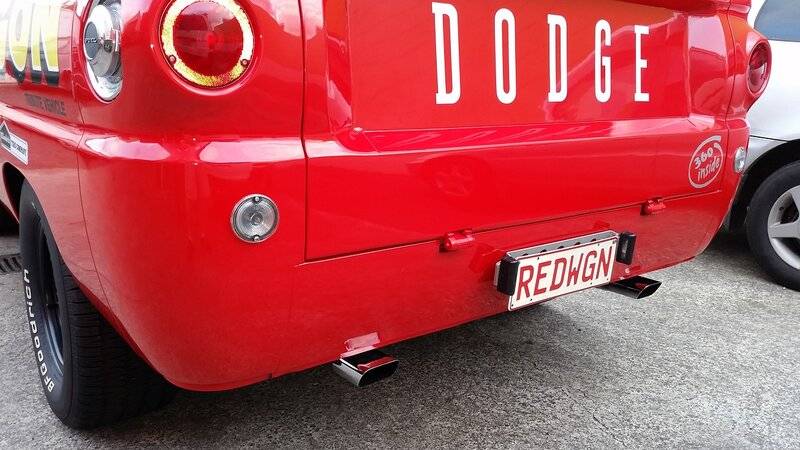

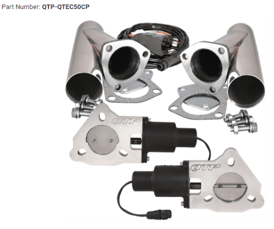

I have QTP on my A100 .....love them. Switch is just out of the way.....not allowed them on the street. Drag strip mode is easily obtainable at will. Full stainless exhaust except for the ceramic coated headers. Also have the angled tips after the cut-out exit. Full exhaust over diff etc to Charger tips.
I have heard that there are cheaper cut-outs available....but since I only intend on doing this once, I wasn't worried about buying a more expensive system.
Quick Time Performance QTEC50CP Quick Time Performance Electric Exhaust Cutouts | Summit Racing

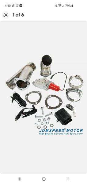

I bought the Patriot version. One thing I like is there is no switch, they work off a remote fob.
My 3" max wedge type exhaust already had the cut outs so it was a pretty simple install

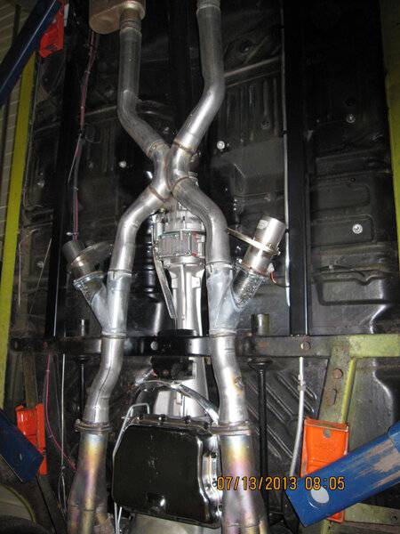

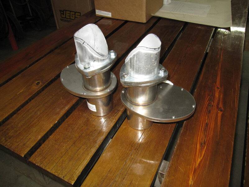

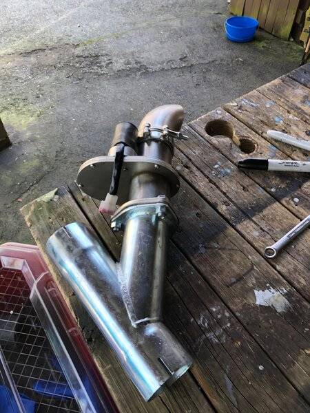

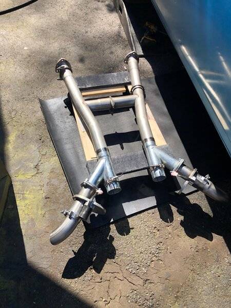

Doug’s here, according to my son the best thing we have every done to the car.
3412819D-F82B-4EA6-AE86-5F154944A252.jpeg 10543B1F-EB9F-4E6D-9162-3FFE4049ABA6.jpeg
My only concern was all the wire in pipe proximity. I came up thru the back seat foot area rubber floorboard plug, under carpet, and down the door sill passage on each side. That meant maybe 6” of wire under the car. Worked great. Since I have dynomat, it self seals against the wire.
I have had the Doug's on the RoadRunner for 20 years, I bought 1 of the 1st sets @ the SpringFling.. In my opinion they are the best for sealing, but are on the heavier side so I had small side supports added. The butterfly type cutouts seem to develop leaks after a few years, whereas the sliding gate of the Doug's tend to clean itself. The only thing I have had to replace was the DPDT toggle switch(made in China) supplied by Doug's, I went with a mil-spec replacement DPDT switch made in the USA.

Wow, that price is about $150 higher than 2 years ago. I don't need them that bad.
