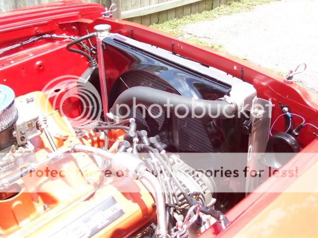

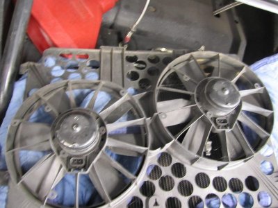

Nothing wrong with using an electric fan back-up as thats what I do. I use a stock type flex fan and a shroud that I modified to fit as its from a Dakota V/6 truck. I have an Afco aluminum rad and I have the electric fan in front of the rad as pusher and its on a toggle switch. I dont use it in normal traffic but if I sit in traffic on 95 degree and hotter days I will turn it on to keep it at 190 and lower. It will creep up to 200 on real hot days in traffic if I have to sit for a good bit and I dont like it at 200 so the backup fan brings it down and keeps it around 185 to 190 on super hot days in traffic. Its nice to have it when sitting in traffic for a bit. You can see a little bit of it in this pic. Ron
Here is my fan and the shroud I modified. Ron
Wizard Cooling, 4 row aluminum with 26 inch shroud. Add yourself a six blade Hemi Clutch fan and your going to be really happy. The measure the distance the back of impeller is to body of pump and make sure it is no more than .60 thousands from the pump body. If your still thinking you need additional the go to junk yard and find a mercedes S class 2 speed fanshround from a Coupe. Mounter under car facing up.

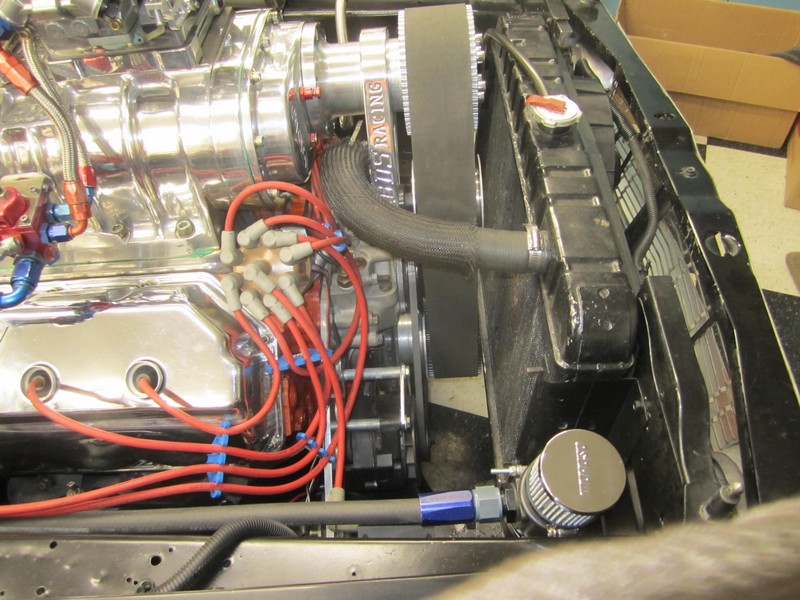

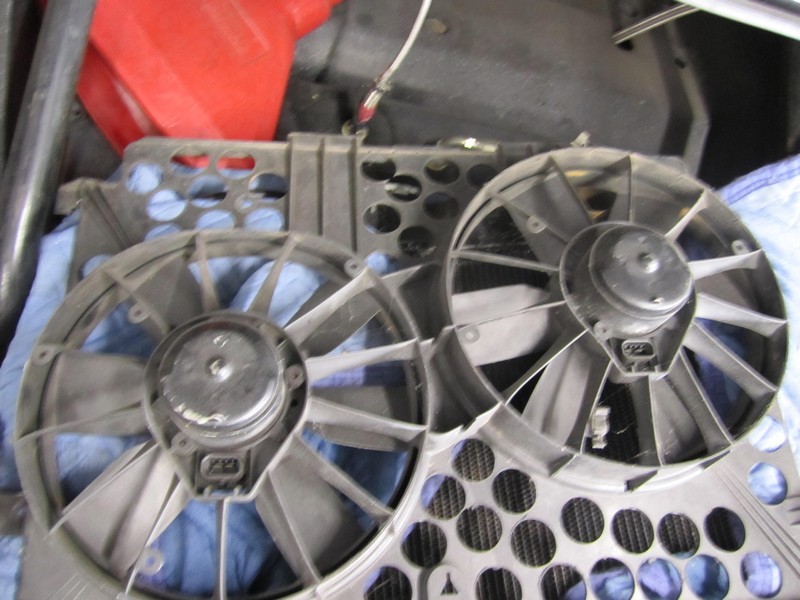

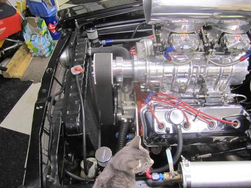

Your engine combo has a lot to do with your cooling needs. I use a 4 row copper with 2 pusher fans because there is no room for an engine fan. In bumper to bumper traffic it might go as high as 200 on a 90* day. I am looking into an aluminum 3 row for the weight savings. What is your engine combo,compression ratio and HP level?
