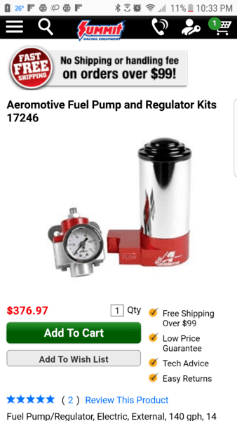

What model Areomotive would you suggest ? There are many. Thanks
I'd likely go with this kit. I'm contemplating boosting mine so I'm holding off until I make up my mind... spend once lol.
Didn't see where it mentions whether or not it's a return style regulator? I'd go with a return though.
Thanks for the input guys, that's what I was looking for and yeah, I don't want to do this twice so keep the feedback coming and I'll keep digging into it. It's looking like that Carter isn't going to cut it. I originally started leaning that way because all the reviews are good, some of the others are all over the map, holleys in particular.

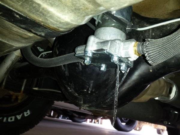

This was my Holley on the first run, right out of the box...
Gasket was installed crooked and leaked like a seive.

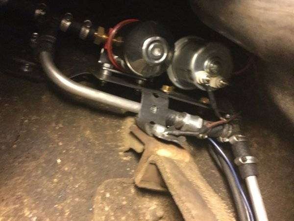

I run both an electric and mechanical in series. I routed a bypass line with a one-way check valve around the electric so the mechanical can pull around it. I only use the electric to prime and at the racetrack. I switch it on just before I stage the car. The electric is mounted on the front side of the axle tunnel. It’s a little above the pickup, but has worked just fine thus far. I run a 1/2” pickup in a stock tank and 1/2” line all the way forward.
