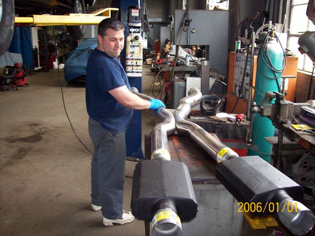

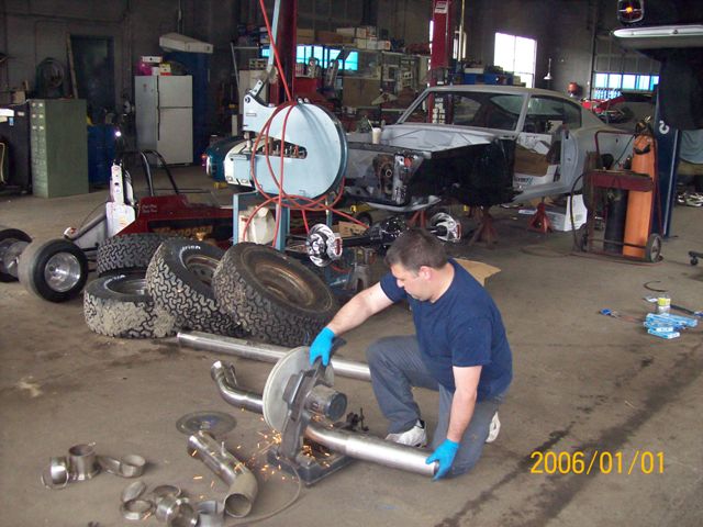

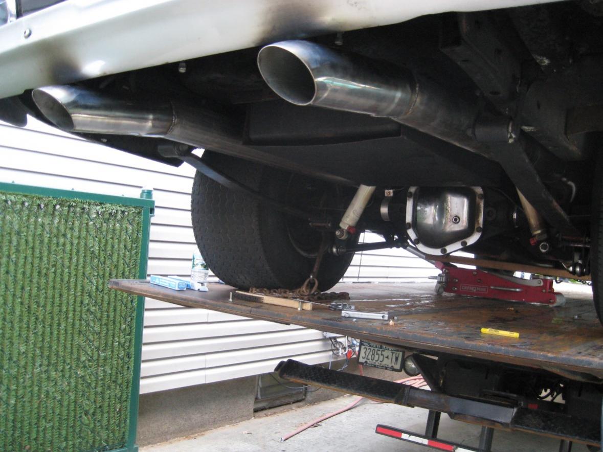

What a crock of ****:puke:I have a 4 inch system with tailplpes going into the mufflers with band clamp.I also use band clamps where the pipe slides onto my collectors.If you use the U-clamp,it dimples the pipe and makes it VERY difficult to R&R the tail pipes.The hangers holds & supports the system.

Thank you very much Hemi-Itis!!!! Where did you get those band clamps?
Local parts store.I used the Walker exhaust brand.Thay make the dynomax muffler line:usa2:
