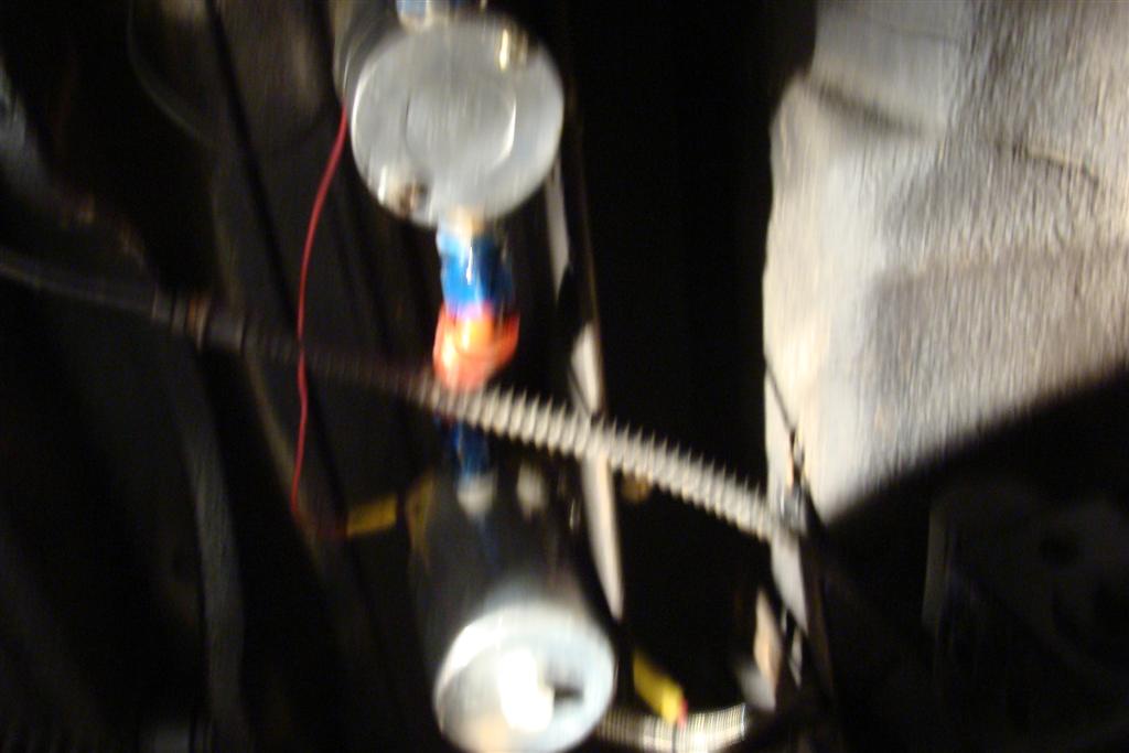

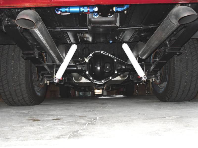

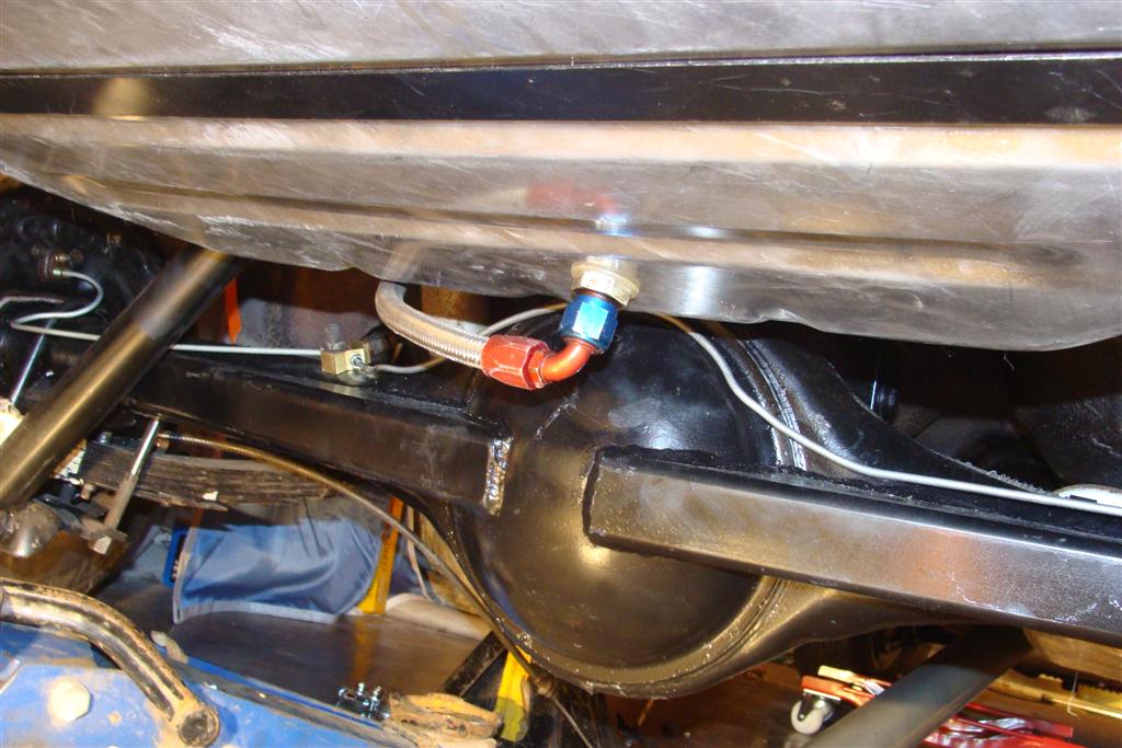

This is where i put mine.
I have mine in the old filler neck location - center rear. You can sort of see it in this picture. It's a holley HP150 mounted vertically in the well where the filler neck used to go into the tank. Sort of tucked up out of the way and yet still low enough to have the inlet below the lowest point of the fuel cell.

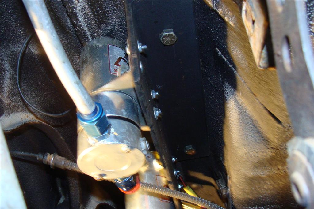

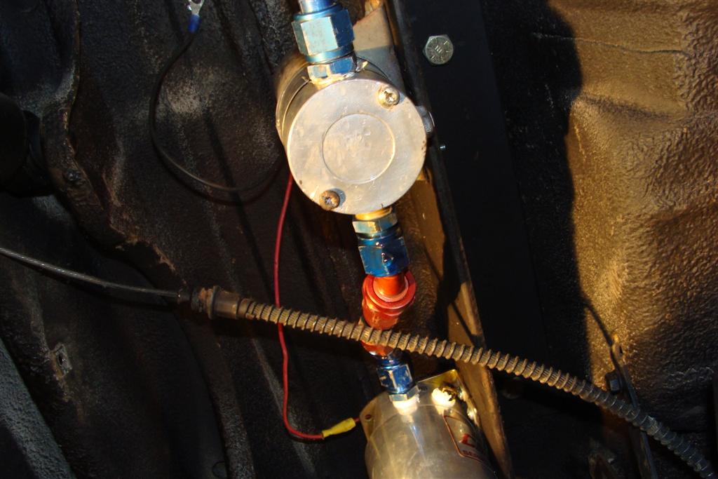

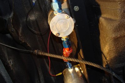

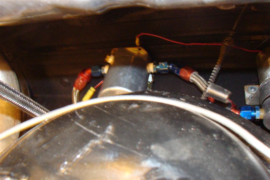

I,ve got a coronet with a factory tank. Not a lot of difference.
Isn't that in front of the tank above the differential?
yep but it works great. I had to pressure up the tank to fill the filter initally but the pump primes off the filter canister now,no problem. Its feeding a 1150 dominator on a 500. Only option I had unless I wanted it to hang below the bumper which aint cool on a street car.
That is a very nice job! Everyone else was suggesting that I mount the pump behind the tank in front of the rear bumper and I totally misunderstood your initial comment. You are exactly right in your suggestion and thanks for the pictures! Merry Christmas!!!!!
