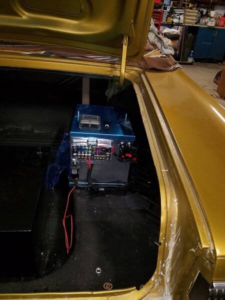

I have a fuse block, the inertia switch and pump relay mounted to my battery box, it feeds my relay and audio equipment , so I didnt have to run from the engine bay. compartment
