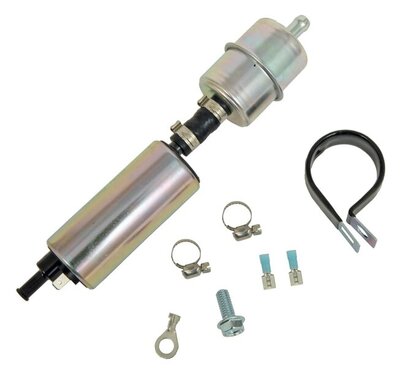

I would go with either the holley black pump or a Aeromotive fuel pump. For a return regulator go with Aeromotive.
These work well. Hook it up to a momentary switch, prime the carb, and bingo!
Holley has a nice one as well. https://www.summitracing.com/parts/hly-12-427
The cylindrical one with the filter attached is a Airtex I believe. (E8012S)

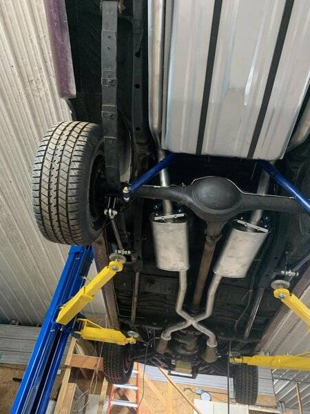

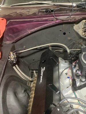

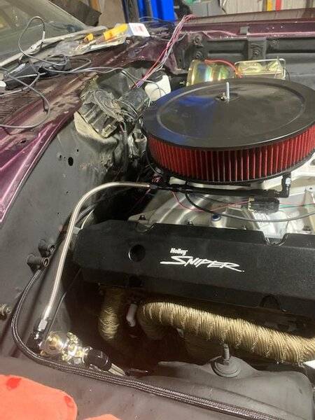

I went with the complete system from tanks inc. and it has worked flawlessly for me up to this point, I am running an EFI set up but premise is that same I have an external regulator up by the motor with a return line and intank pump. I would recommend getting a fuel injection tank it has additional baffles to hold fuel around the fuel pick up during acceleration.
https://www.tanksinc.com/index.cfm/...ct_id=484/category_id=68/mode=prod/prd484.htm

View attachment 1201934 View attachment 1201935 View attachment 1201936
Looks good, I'll have to mount mine elsewhere since my A/C lines run through there. I'm back and forth on putting it in the tank, I know that's the best option but in a pinch it sure would be easier getting the car back on the road if it was accessible.
As i mentioned I have not had any problems but FWIW the research that I did prior to going with the intank pump suggested that in tank pumps were more reliable because of the added benefit of fuel cooling the pump. And its quieter.. Good luck on your decision!.
