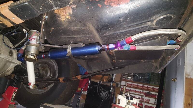

Where is everybody mounting there electric fuel pump on a 68 b body. I have a Holley electric fuel pump black it’s quiet large and instructions say to mount below and near the fuel tank.
There simply no area where this can b done without fabricating some weird bracket. Anybody have any photos of how there pumps are mounted

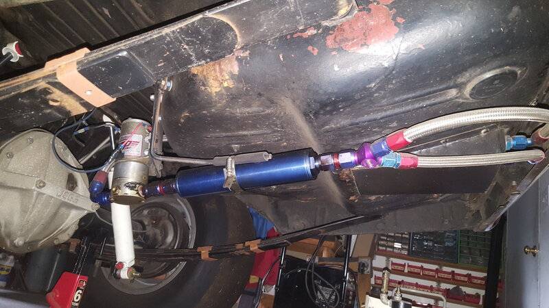

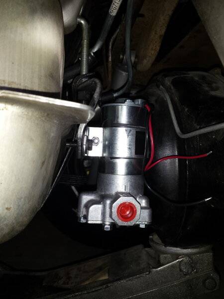

Yes, that is what you want to do, make a bracket that is lower than the tank if possible. and with as close as possible, large suction line is very important, suction flow is critical to pump performance. The pics are my "over kill" setup to feed a 512 6500+ RPM motor. For something tamer I'd make the suction side line at least 3/8" and at or below the tank.
Edit: my tank is a fuel cell in the spare tire well with 2 cell outlets. Two #8 out of the cell, wye into fuel filter #10 into pump, #8 & 1/2" line up to firewall regulator. 140 Mallory pump.

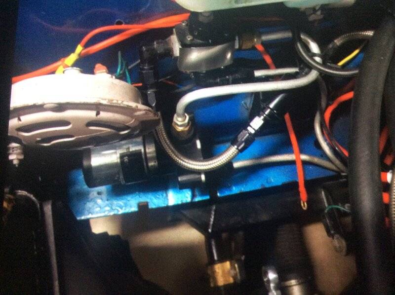

Maybe a slightly different beast, but I mounted mine to the 4x5 removeable plate on the right wheel well in the engine bay. It is below and slightly behind the alternator. I have a 71 b body, so hopefully you would have plenty or room. I couldnt find enough room along the frame rails either. I coonected it with a short piece of hose to the end of the steel input line. Works great !
Photo above is where my friend mounted his. He says it works great even though it looks to be above fuel tank and it’s mounted in front of car well beyond the 12” from fuel tank the directions call for

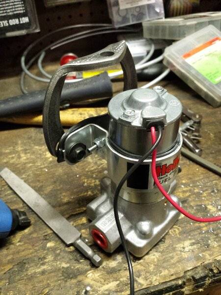

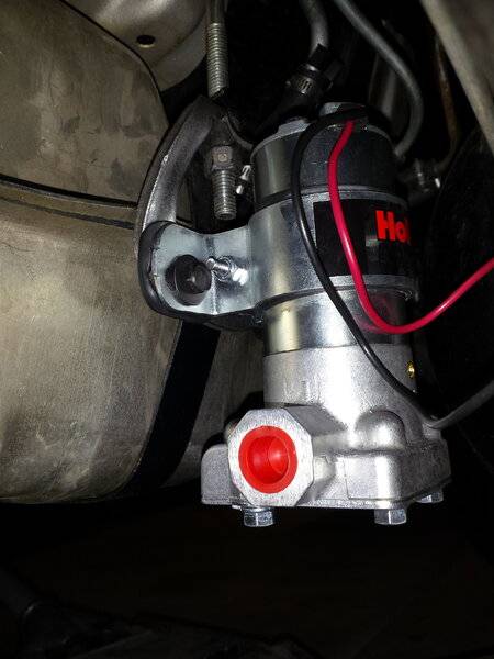

I built a mount that bolted the pump to the fuel tank hanger j bolt. Worked perfect. Made from a 3 bolt header flange.

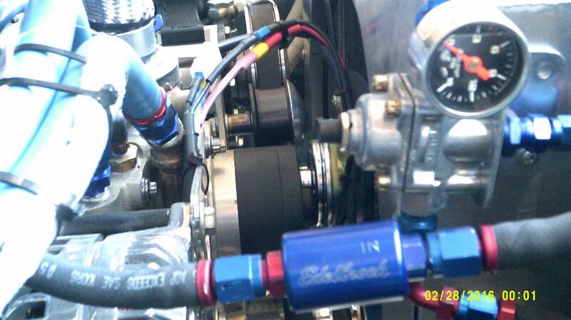

I have a Aeromotive S/S 14 psi pump, 6bbl set up
(along with a by-pass style regulator at the radiator support
by-pass reg. has a separate line from the reg.
all the way back to the fuel tank, into the sending unit)
has a 10 miron fiter up just before the carbs too
