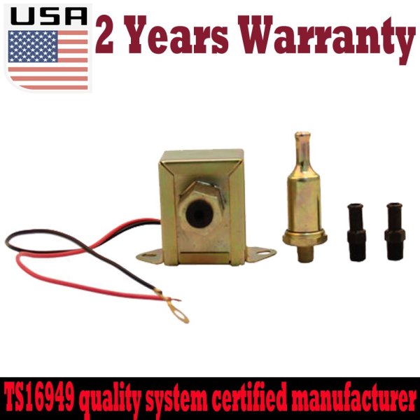

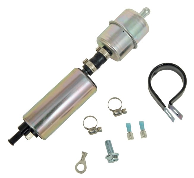

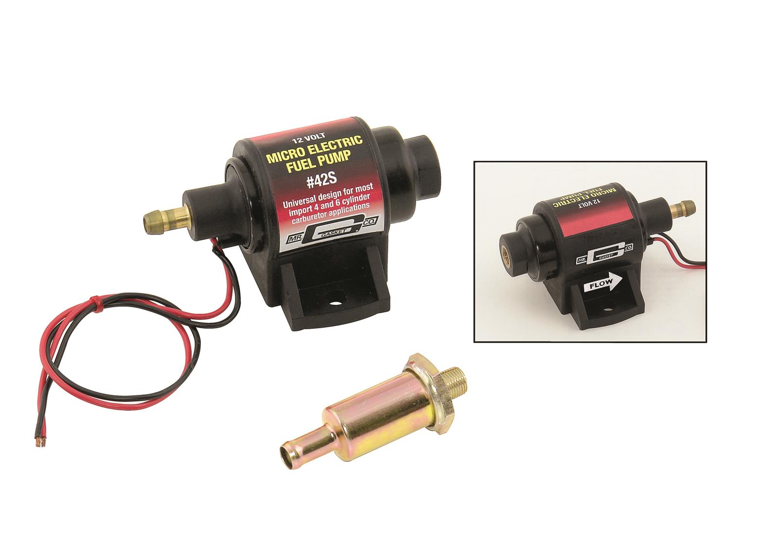

If you have to crank your engine a lot to fill the carb bowls after it has set for a few days, you may need a electric priming pump. Hook it up to a switched 12v. source, protected with a fuse, and operated with a momentary contact switch and your problems will be gone. Here are a few pumps that work well, are quiet, and fuel will easily flow through them when your mechanical pump is doing it's job.
