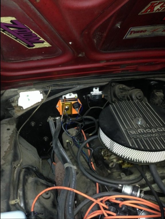

thank you for your help. Please post pics of your ECU and new voltage regulator set up.
Mikey- I changed over last summer w/o changing the VR. After much reading I went to a transistorized regulator just recently. Probably much better regulated voltage, I do notice a little less jumping around of the original amp gauge on my '68.
nk
Here ya go. VR came from autozone,same mounting holes&wall.

Yup ranger same VR..Works great.
