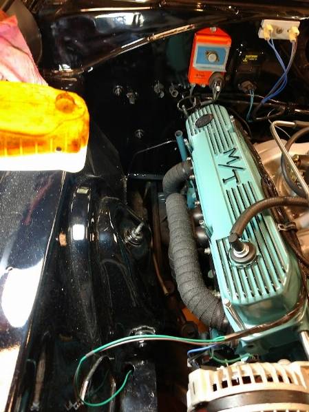

Little info: 1966 Dodge Charger 383 with Holley sniper efi. I have all new wiring inside and out. Previous wiring was all jacked up. It does have a electronic distributor. Alternator is a 2 field alternator and I have ran a wire inside the ballast resistor for my constant hot for ignition sniper wire. What do I do with the other open field on the alternator? Thanks for the help in advance I am dumb when it comes to electrical, this build is for my dad and the good memories I have as a child in his orange 66. He is no longer with me anymore and I sure wish I could have his advice but this forum is the next best thing so thanks again everyone that has helped me on this build and there’s been a lot
Is it not starting? What is exactly happening or rather not happening?
I think they are wondering what to do with the other field connection at the alt, looks like a square back with two fields. If that's the case I've always heard to ground it to the case of the alt.

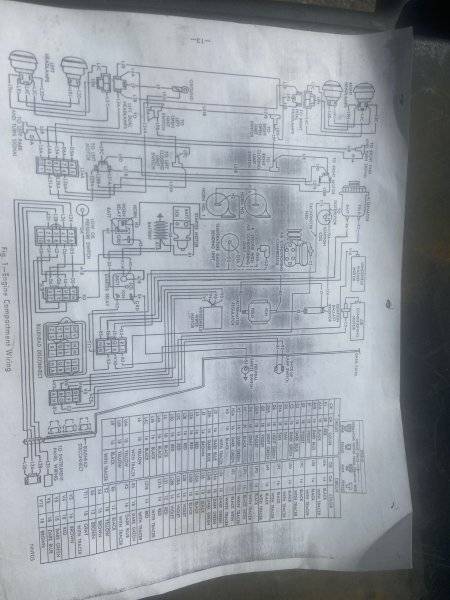

At first the battery voltage slowly was dropping and I noticed that the wiring to voltage reg and ign ballast was wrong according to my wiring diagram so I switched it and then I noticed that my dumbass had the brown washer pump wire hooked to the 2nd field wire so now there is no wire going to it. I read to ground it also but I just like to double check because I do not wanna fry this harness. That’s what happened when I first bought the car. The bulkhead had 2 wires fried. So I’ve done all new wiring harness inside and out

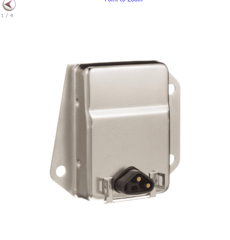

I would suggest getting a newer style solid state regulator and see if you can find a plug/wires to match it. Then you'll get the best performance out of your alternator.
I did that and that’s how I found out my wiring was wrong also because it started to smoke. Was thinking of fixing the smoked wire nothing else seems smoked.
That's still an electromechanical relay.
Like the black one shown here:
Almost any mid 70's -80's Chrysler had these:
You can get the plug as well from RockAuto:
But your alternator isn't.
It's a better setup than the original.

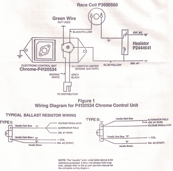

Maybe this from DC way back can help...........
Although this diagram is for the MP "Race" components the wiring works for the basic matched components.
If you have the older pre 1970 regulator or the round back alternator, you need to ground the other field on the squaer back alternator.
If using the 1970-up electronic regulator, the ignition power (blue) goes to a field, and the green wire that goes to the voltage regulator goes to the other field.
