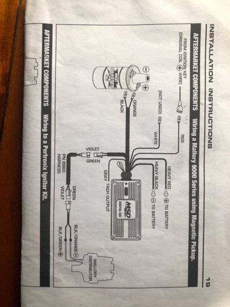

In a 1968 Coronet, 440 I have installed (upgraded) to an MSD electronic ignition system. Using wiring diagram that is on page 19 of the instruction booklet, attached. I have an MSD distributor, part number 8546. Cannot get the car to start. Ok, a little back ground, the engine is freshly overhauled and installed, has not ran yet. I know I am getting gas, I know the fuel pump is primed. I have checked spark and am getting it (only checked one plug). I get a nice crank and can hear the compression, but I am getting flames out of the top of the carburetor. I cannot get the engine to start. I have checked to the distributor is not 180 out, its correct. I've also confirmed plug wire to cylinder location *firing order. One thought is to go back to a points ignition to see if I can get it to fire......thank you all for your input.

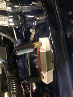

I think you need to put a jumper across the ballast resistor as well.

spark is crisp and blue. I will confirm the timing via the light, throttle wide open plugs out, no fuel. what will jumping the ballast do for me?
Yes I believe the MSD is looking for a full 12 volts on the ignition. But if spark is blue and crisp you should be fine

I agree. No need to tear everything out. First, MSD needs a full 12 volts. Bypass the balast resistor. Then, if it doesn't start, look at timing and firing order. That is where I found issues when the engine backfires through the carb.
There should be no ballast resistor in use with an MSD. The MSD ignition sense leads needs to be connected to both Ign1 (blue) and Ign2 (brown) engine harness wires.
using the wiring diagram above I would attach the blue and brown wires to the MSD red wire sense lead and completely disconnect the ballast, correct? Thank you.
