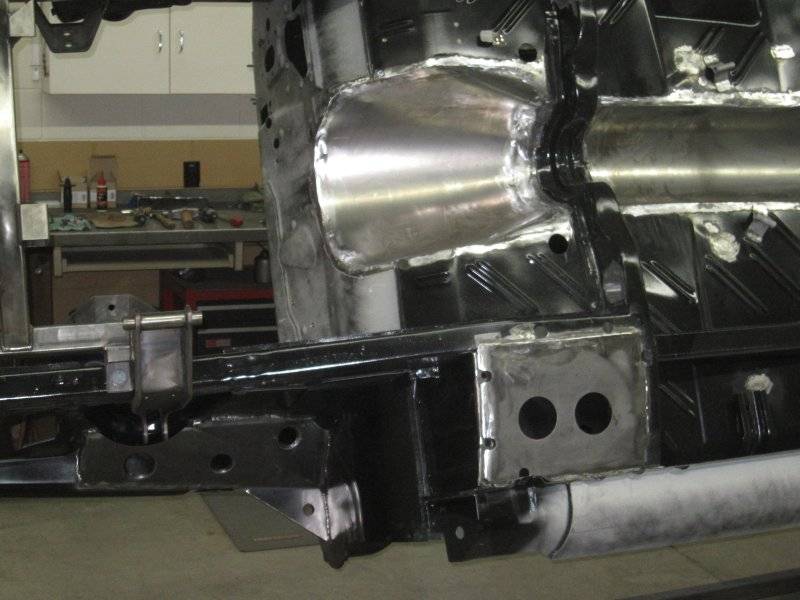

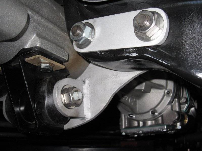

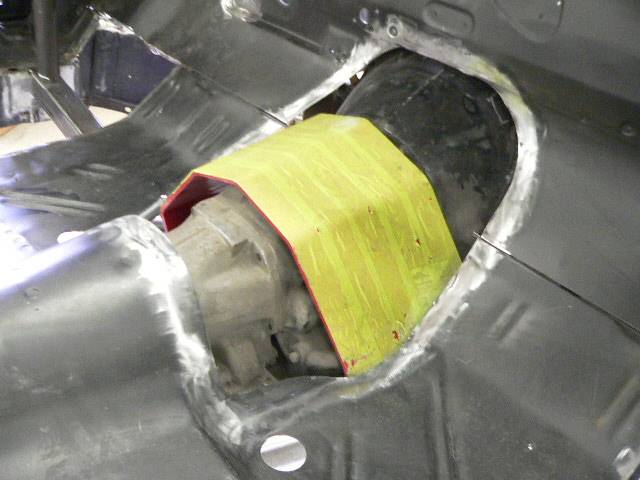

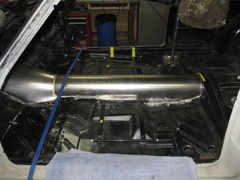

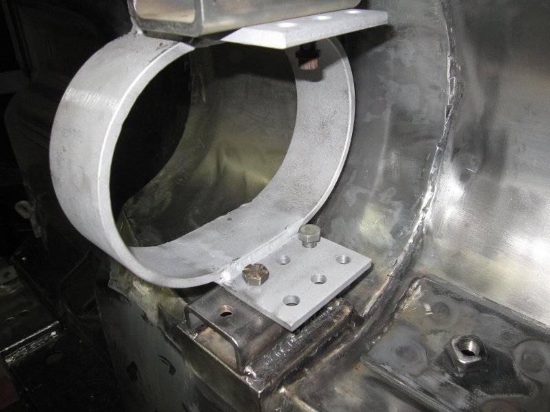

I followed Doug's advice on my 65 Belvedere. I too am using a RMS front suspension but, I am using a TF w/Gear Vendors O/D. My K-member came with wedge engine mounts but, plans changed and I needed Hemi mounts. So while tacking the replacement mounts in, I set the engine back as far as I was comfortable doing. That necessitated cutting (my new AMD floor) the tunnel and bell housing area out. A new crossmember that was real easy to fabricate, got my power plant located. I have attached a couple of photos here. If you want more PM me.
Mike
Mike

Very nice, nice execution and attention to detail, lot of hidden tricks there. :thumbsup:
