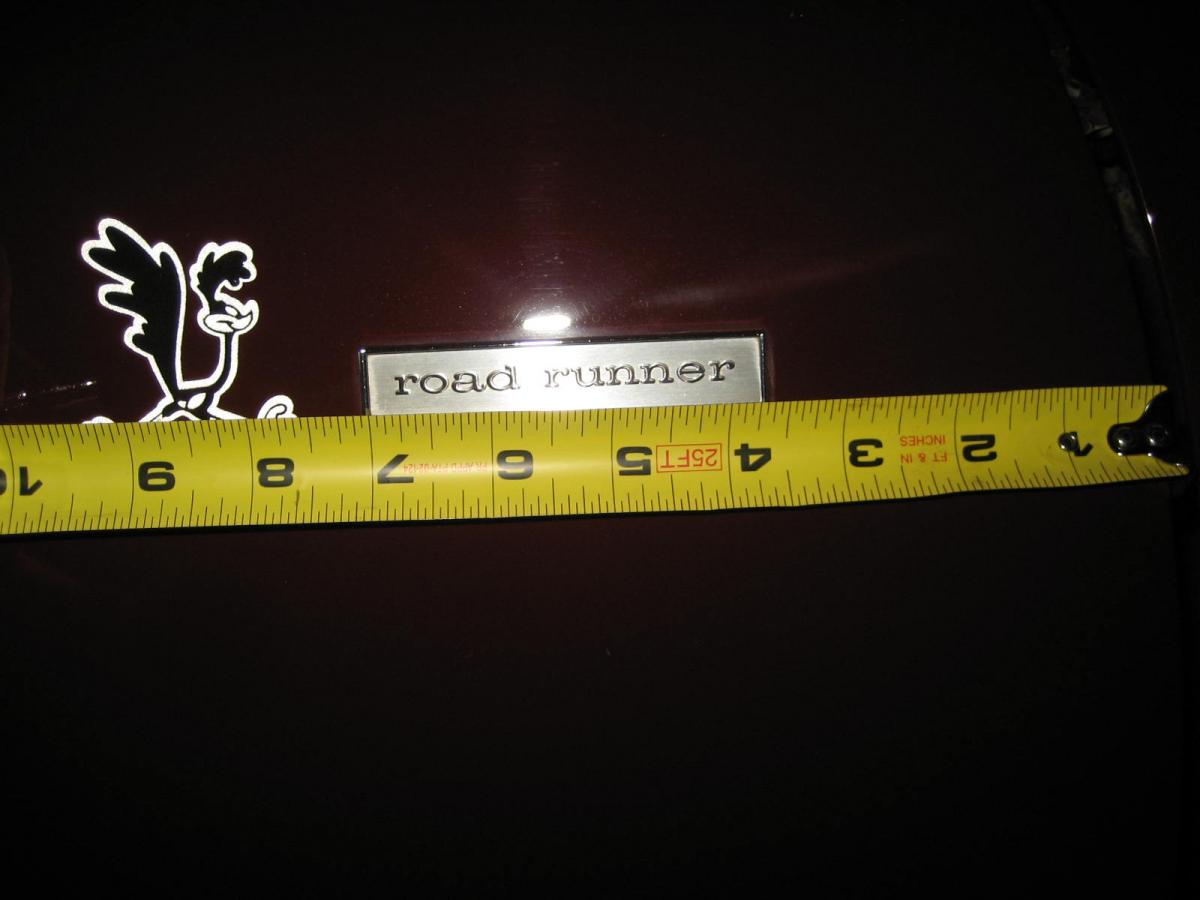

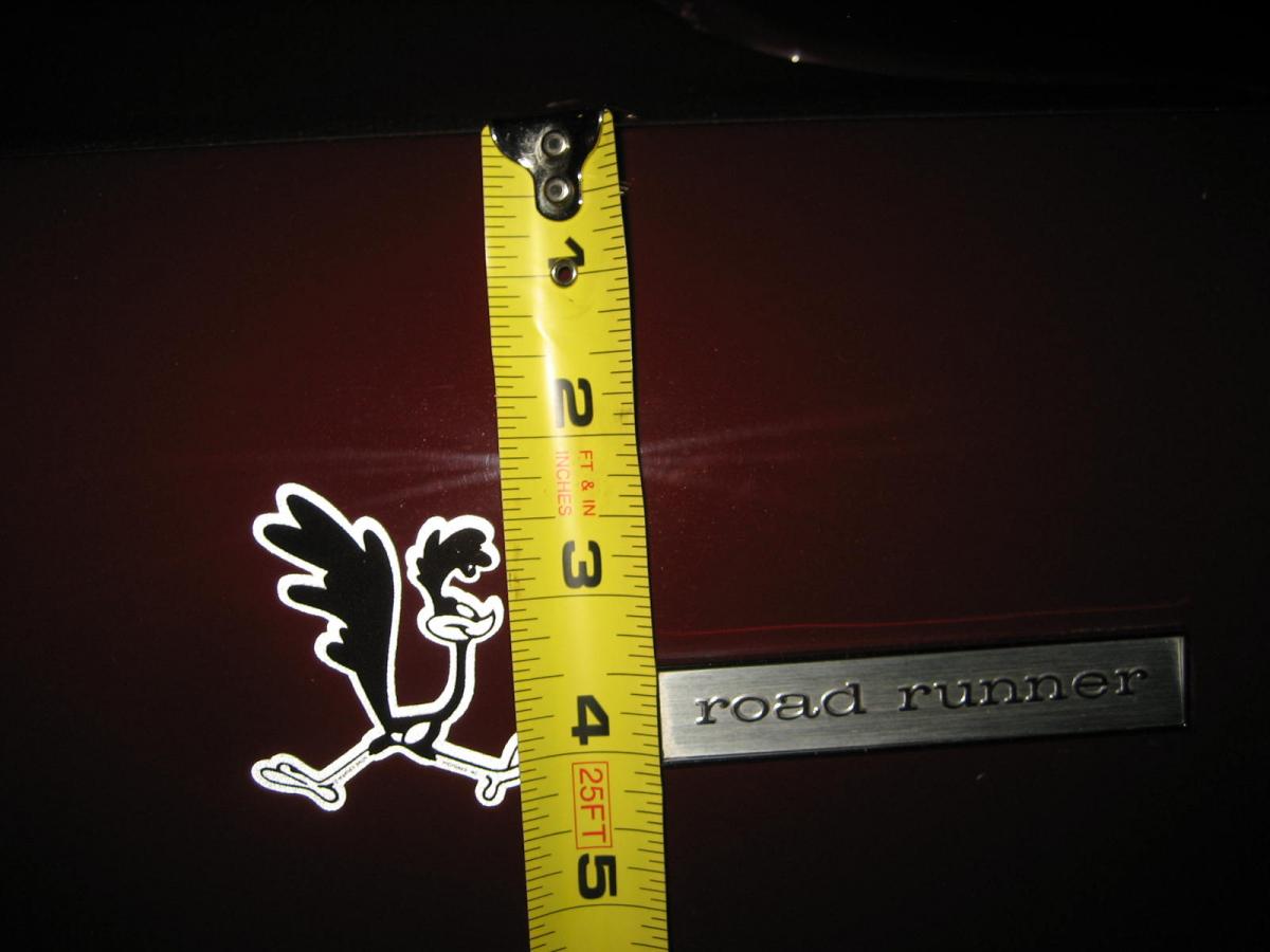

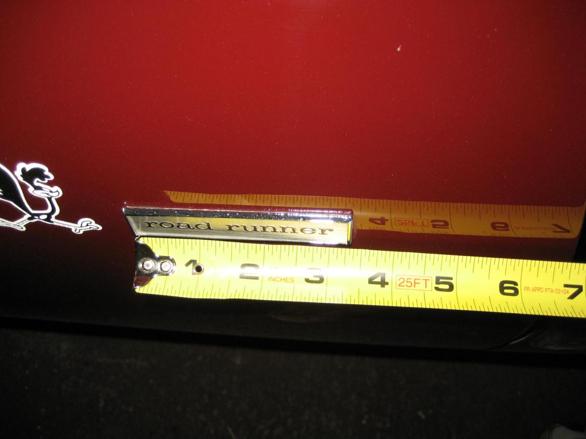

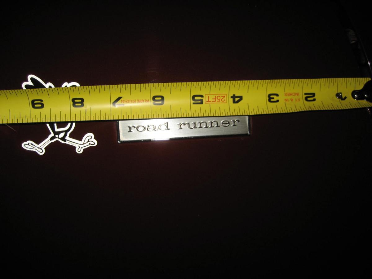

Lets see if these help
And without the emblem. These are with the tape hooked on the ft edege of the door and from the top body line. If you need more let me know. I also have a bunck of pics of the org birds before they were removed if you need those also.

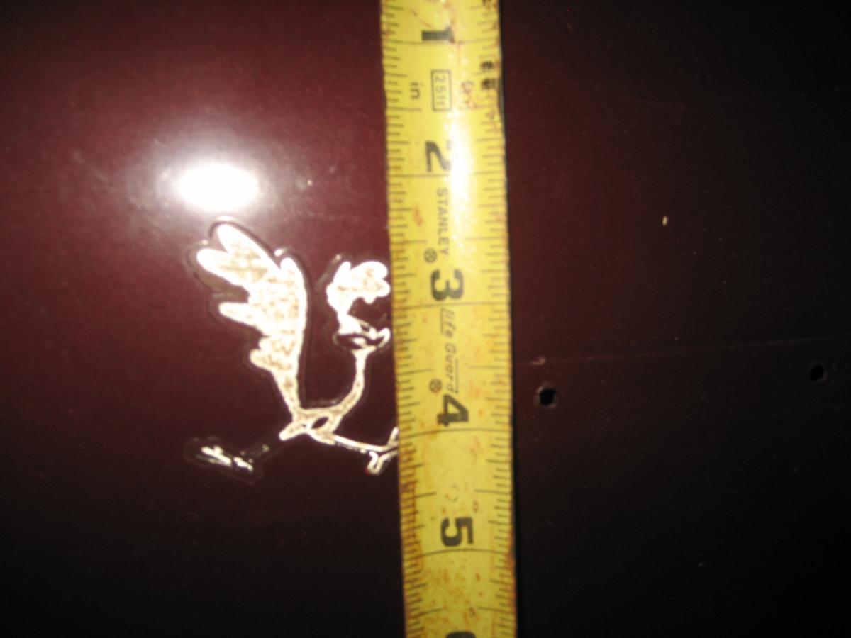

Ok and for the dash, last pic is from the edege of the instrument cluster.
