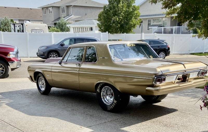

Load up time..

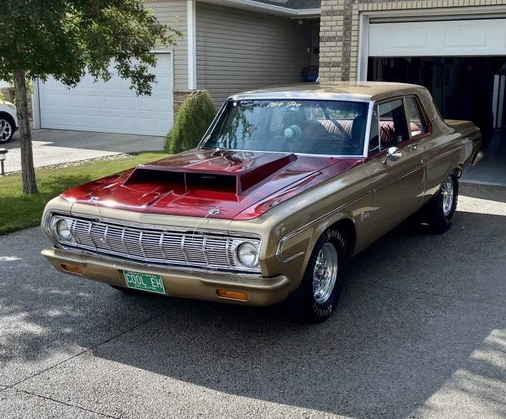

Off the hoist and ready to load up. Haven’t been posting much this season but there’s been lots of tinkering going on.

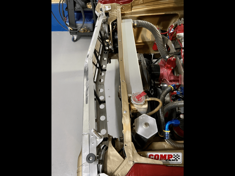

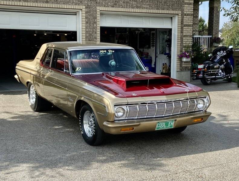

A different look up front. Been in the works awhile.

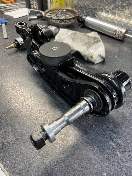

Last race day, 3rd round. Car launched both hard upward and hard to the right. Came down hard and off the track surface. Gathered it up and straightened out ok but with the steering now pulling to the left the race was over. I suspected that the run might go bad when I saw who was making a pass directly in front of me. In any event, had the front end apart for inspection, some parts, some repairs and back in alignment. Good to go this weekend.

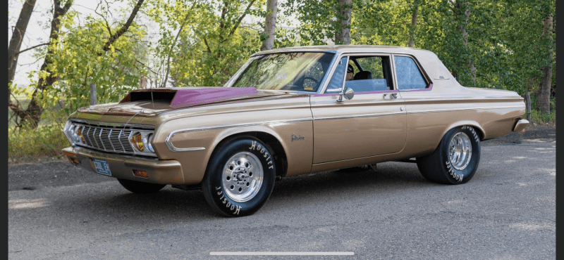

This was a picture that someone had taken during a previous race day this season. It’s the drive up to the staging lanes. It was shared to me.

What weight is your setup at now?
Mid season I checked and it was 3262 with 6 gallons of fuel, less driver, now at 3240 now with the steel hood and hinges still. With the glass hood and lightweight hinges it’s going to be 3200-3205 less driver with the fuel.
Replacing the stock hood & grill supports with aluminum and headlight pots/bulbs removed was good for 11lbs off
Always thought you have a great looking 64. Good luck on your runs.
Very "cool eh" indeed!
Hey, is that a hockey puck I see on that control arm?

If I din't know any better, I'd say that looks like a hockey puck bolted to the lower control arm?

This car is gorgeous and at good weight being for what it looks to be as a full interior ride. A glass hood and lower height scoop should get you to your objective. I love the '64 race Hemi front end look. Yes those bulb pots and the metal around them weigh a pretty penny for what they are. Good luck over the weekend.

Yep, hockey pucks. If you’re coming down hard, bolt on a set and save the oil pan.
Yes, they work like a damn. Firm quiet landing and the oil pan hasn’t smacked since they went on.
