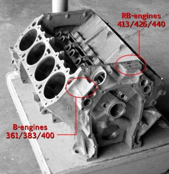

there is no pad on a B block. either way, the motor will go in just fine. measure the bore to see what motor you have. 4.120" = 361 4.25" = 383. stroke is the same. as to whether or not it is a good motor your best to have your machinist look it over. good luck. hope it is a 383 for you.
there isn't a pad like a 440 has, but the engine number is stamped on the block in front of the head by the distributor.
It would be better to see the pad just under where the distributor is. The engine size and year is stamped there.
The above is correct info.... it might be tough to see, you are really only looking for a 36 or 38 designating the size following a letter which designates the year on that pad. There may be other info there relating to build date and possibly other marks as well. If it should be a 361, keep in mind you will be limited to very plain replacement pistons as 361 is considered an obsolete engine at this point. Or you could get custom forged ones but then its $$$$. HTH, Lefty71

I did get a picture of the casting # at the distributor area on the block.
V 38
HP
415
Looks to be a 383. Not sure what this HP stands for. High Performance?
No idea on the 415.
415 is the date of assembly, as opposed to the casting date on the block which would of course be earlier.
Have your machinist check the deck height or stroke length, There was a high block 383 produced in 1959 only. Chances are slim but better to be sure before spending $ on parts.
415: April 15
