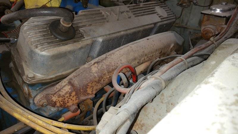

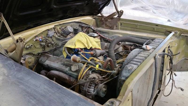

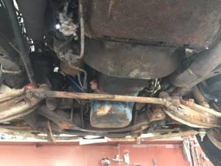

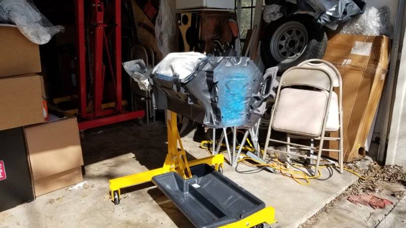

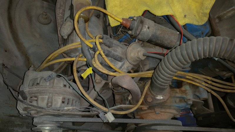

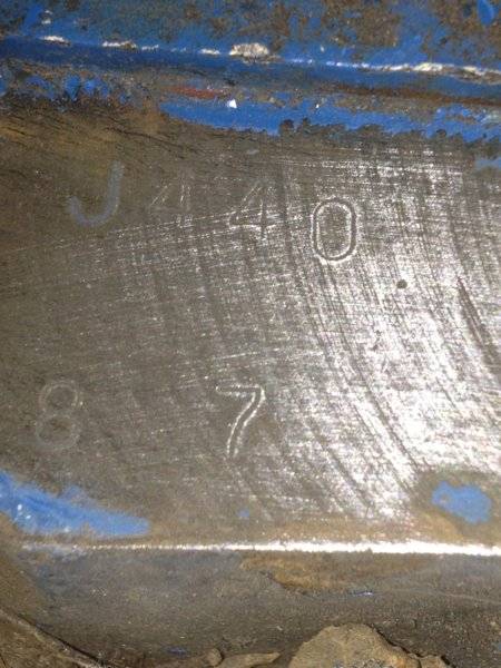

Since the engine rebuild is in parallel with the body work, I figured to put it in its own thread. I started with a 73 'J' 440 std. block. The initial plan was just to do freeze plugs, freshen the heads and put it back in with a fresh coat of paint and FiTech fuel injection. Once the heads were off, that plan went out the window. I don't have a ton of before pictures, its the usual neglected engine.

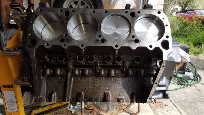

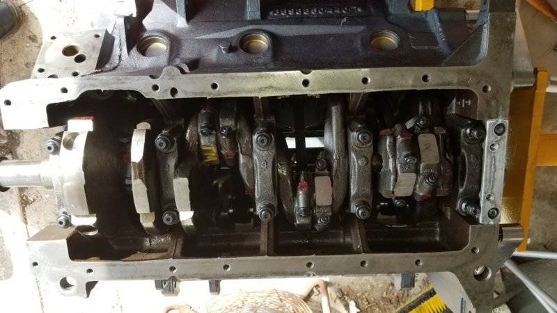

So far, I have the rotating assembly in, the cam and lifters are next. I hope to have the engine complete with the Proflo 4 and serpentine drive bolted on in the next three or four weeks. Plan is to install on K-Frame complete from underneath.

I like the old M/T valve covers, but you need a breather. The pvc valve has to suck in air from somewhere.
Get rid of the plastic fuel filter too. You can get a metal one that will fit right in its place. I like to get all the rubber fuel hoses away from the motor area too, for safety sake.

I got the oil pump, cam and timing chain in last weekend. My balancer is starting to fail, so I ordered the SFI fluid balancer and ARP bolt from 440 source. Seems like there is still something every weekend I need to buy.

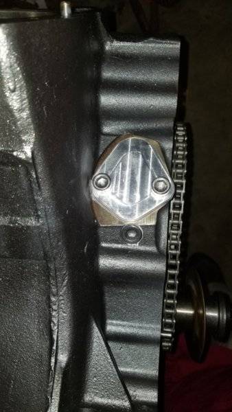

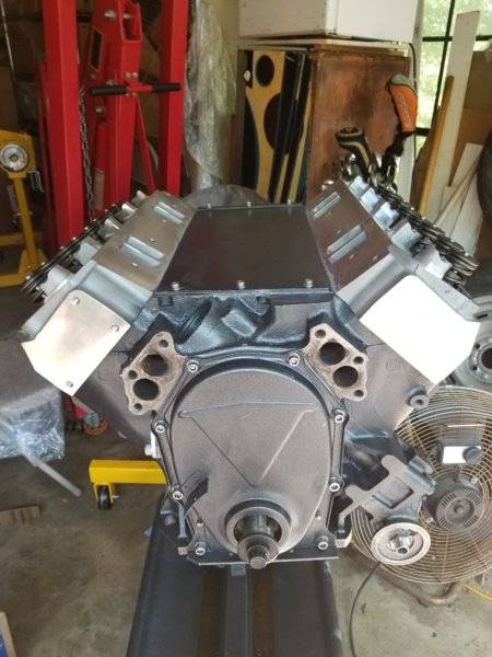

Not much assembly work this weekend, mostly prep. Fuel pump blockoff had to be sized to fit, it was too large. The timing cover seal was a bear, it too almost an hour to get it out. Heads are ready to go on, so maybe next weekend.
The 440src balancer is nice because it's marked to 50 degrees. Unless you're real lucky be prepared to have it honed out though, .001 was good on the couple of them I've used.

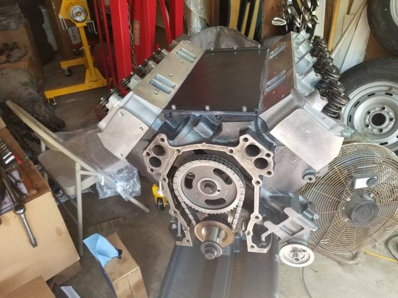

Got the lifters, heads, valley pan and timing cover put on this weekend. Starting to look like an engine again. Still have a ways to go, valve gear, oil pan, windage tray water pump and front dress. I'll set up the dist drive, but it'll have to come back out for pre-run pump priming. Getting closer.
