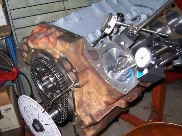

Just to give you an idea here is what I am using. I decided on Indy EZ heads for the 493 I built for my 63. Its a .030 over 440 with the 4.15 crank. I had to used these dished pistons to come out at 10.6 with the Indy heads that have a small 75CC chamber. And these are right about zero deck and have the flat so with a .039 head gasket I have good quench. It runs good on 92 pump. The flat top piston would have given me 11.8 comp so I went to the dished piston which actually put me about 10.2 so we cut the head a tad as I wanted around 10.5 to 10.8 since its an aluminum head eng. It works great and runs 10's thru the pipes on pump. Ron
