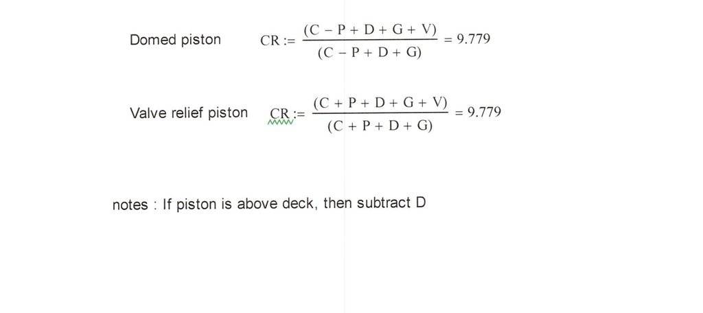

You need the actual chamber size in CC's and the correct deck height in inches. When you have that info, use this formula:
CR=(C+P+D+G+V)/(C+P+D+G) for a valve notch piston
CR=(C-P+D+G+V)/(C-P+D+G) for a domed piston
Below is my worksheet for your example, but you will NEED to adjust the correct chamber and deck height numbers to be correct.
Based on the information given.... assuming the block has been decked .025 and is 10.700 and assuming the top ring is down .300, I get 8.99:1. If the block is taller, it will be less.
