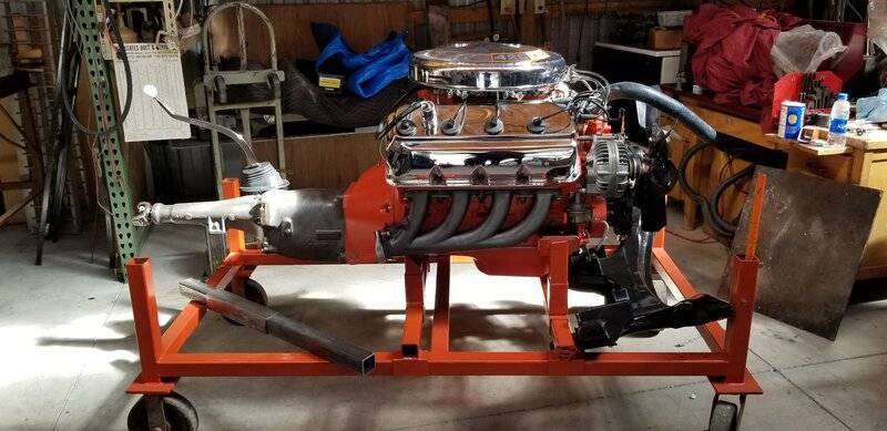

Hello guys
My engine and transmission been covered with a couple blankets since the dyno 2 years ago.
my concerned is if any contaminates such as airborne grinding dust partials that could get into the motors internal some how by just sitting in the same area as the car i am working on?
I do turn to motor daily with socket with ratchet.
Will I need to do a tear down a clean the entire motors internals at this point?
This is a points and condenser engine.
This is critical and don't want to take a chance on ruining the motor.
I would like to fog it........ if it is safe to do so
I want to hear any comments pertaining the engines safety.
Thank you

Only a blanket covering ? No plastic bag (like the engine builders use for storage?")
If the picture is a true representaion of the 2 year storage and the ends of the exhaust manifolds had at least a rag stuffed into the ends, should not be a problem.

The photo of the engine was taken 2 years ago before I covered it..
never thought of the exhaust manifolds exits with rags stuffed.
