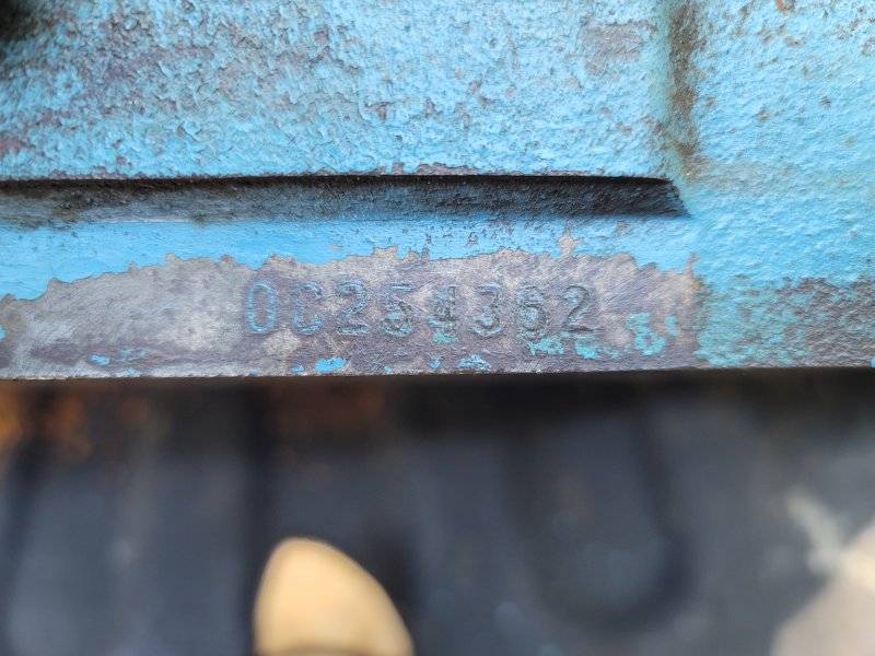

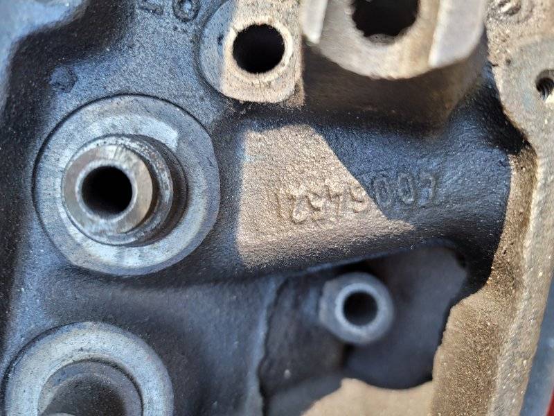

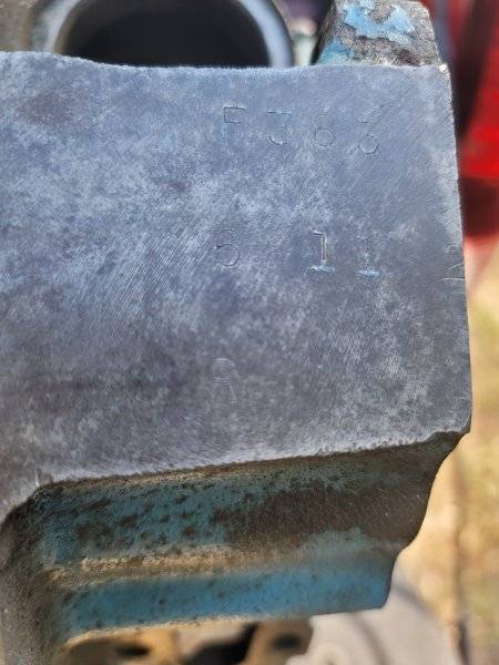

I just got this engine can someone help identify it ? Any help would be greatly appreciated.
1970 383 with later (76-78) 452 heads.
I was told that because of the R very hard to see on the engine stamping that it was an HP is that true ? I've never heard that before.
70 383, put in a car at St Louis assembly plant, in late 1970 run.

the R means regular fuel, so a 2 bbl engine.
HP means HP. Nothing else. No secret decoder needed.

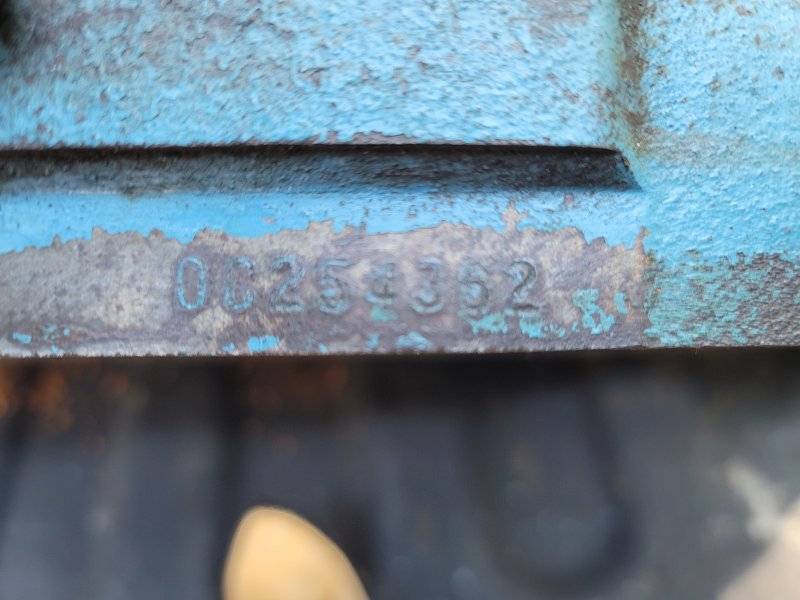

that block stamping looks like it starts with 0C to me which is a plant that only made C body cars.
I read that as 0Gxxxxxx. You are probably right.

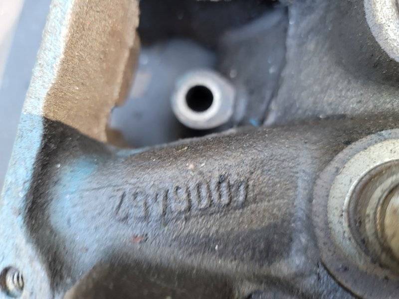

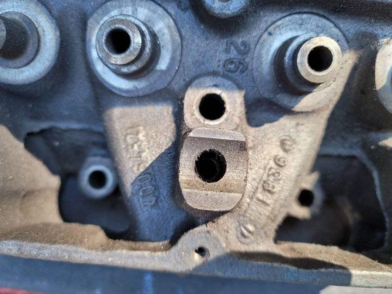

Date code on the head casting shows 1836 for 183rd day of 1976.

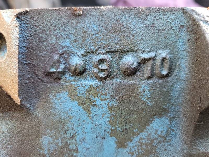

Engine assembly date is 6 11 (1970).
F383 = 383 assembly for model year 1970
0C254362 VIN indicates a likely 616 SPD at the Jefferson plant also meaning it's out a Chrysler Newport, Newport Custom or Town and Country wagon.
Since it's in a Chrysler, it is not an HP assembly as there was no 383 HP engine for a C body.

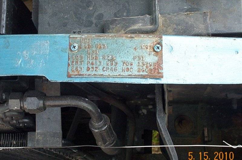

There was an HP 383 option for 1970 C bodies. I owned a Town and Country wagon, numbers matching .
There was an HP 383 option for 1970 C bodies. I owned a Town and Country wagon, numbers matching . View attachment 1365632
There was a 383-4bbl 330 horse version for the C bodies but there was no HP 335 horse. The block in that car would have been turquoise and would not have been stamped HP. Many decoders and sources erroneously list the H VIN and E63 sales code as HP when there were numerous versions of the 383-4bbl for 68-70 A, B and C bodies.
If you are referring as the 5th digit in the VIN as H, it is an N.
