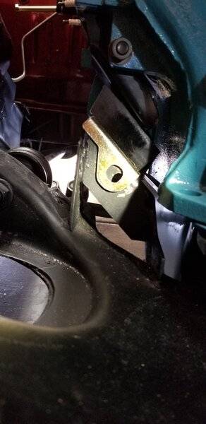

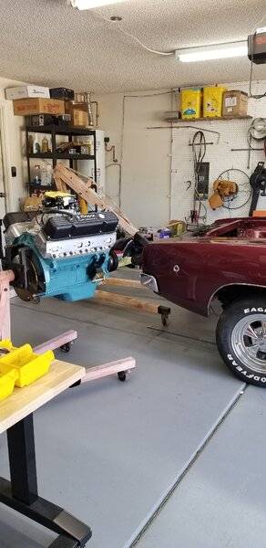

Attempted to install engine in 68 Charger today and had problems. 400 block with Schumacker poly lock mounts. 440 Source engine mount bracket kit. Installing engine with hoist from top. Engine only not engine and trans. No matter what I did I could not get driver side and passenger side engine mount attach bolts installed. The engine was sitting properly in the K member (factory K member never removed from car) but I could only get one side at a time, driver or passenger, bolt to go through. Never both. And just getting one side done was a challenge.

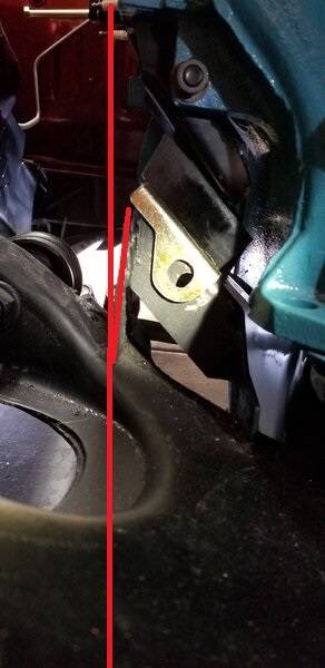

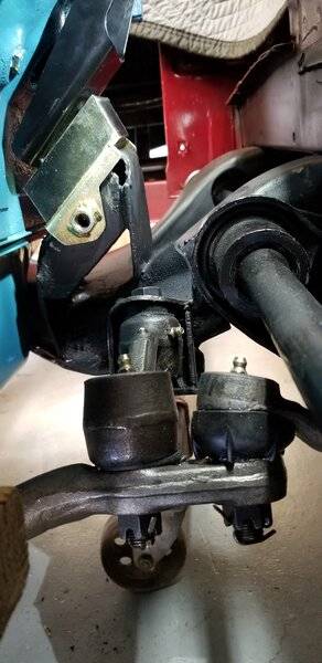

First pic is getting everything ready. Pic 2 is passenger side looking from front of car. Pic 3 is same side except looking at aft end of mount. In pic 2 there is about ½ of hole lined up. Hard to see but in pic 3 but nothing lines up where in the front at least ½ lines up. Your thoughts?

In your second picture it looks like there is a slight slant on the engine mount on the Kmember. Not saying thats your issue but it looks like if it were straight up and down the hole would line up. Is it possible that its bent to the right some?

Need better pictures of the block mounting brackets. They do need to go on their right side for proper alignment. Also bolts go in from the front on both sides. I think!
When I did my motor swap last time I had the brackets on the wrong side of the ears on the block side. It was slightly off and was hard to see. The correct way to install should be the brackets bolted closer to the trans. Just a thought.

I put the engine back on the engine stand and inspected the mounts. Visual inspection says no defects. I'm thinking maybe somehow the the interior of the brackets are not right??
Thats because I loosened the nut holding the poly mount to the bracket. I did this because the front and rear holes were not lining up - I mean not even close. I was hoping to get a little better alignment. Didn't work
This is what I meant. I can't really tell from the picture but it looks to be slanted inwards. I can be totally wrong here.. But it looks like if it were straight up and down the holes would line up.
