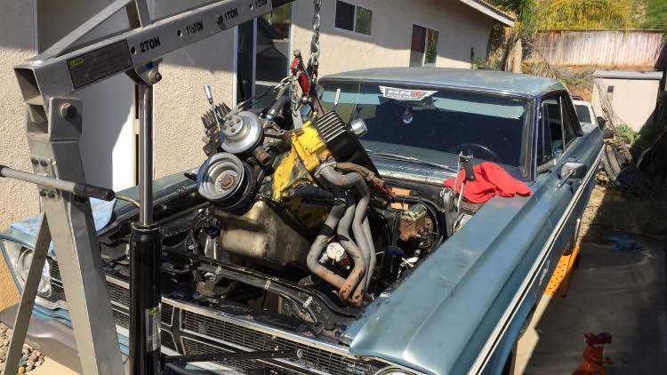

I put the *** end up in the air on ramps or jack stands, then drop both eng/trans in at the same time. It helps having a leveler, I have a new one for the install from Mac's Tiedowns, but this is the combo coming out. (We did the install inside the garage a few years back)
nc_oc=AQn62ZHZI8cMztwWt3PKrkur9D5IO14YPjT3gjqLK-Jss-lygA63QXCjUjME0V02jrI&_nc_ht=scontent-lax3-2.jpg
I like that 64 road race! I never thought of just lifting the rear to make enough room for the trans tail to slip in as one unit. Good idea do you have the front tires off?
every one has great ways, I bolt them together , lift it high enough to clear the radiator support and roll the car underneath them a lower them in place. easy peasy and I do it by myself.
Recently, r&r just the engine, I let the air out of the front tires. As the engine came out, it countered the rise in the suspension and kept the crane height to a minimum.
Pushing the car instead of pulling the crane is much easier.
I like the raising the rear method.
