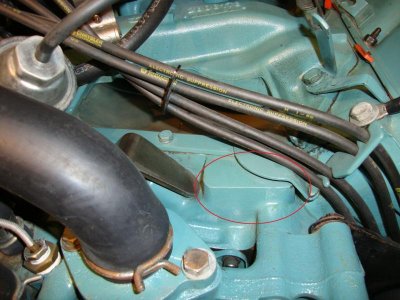

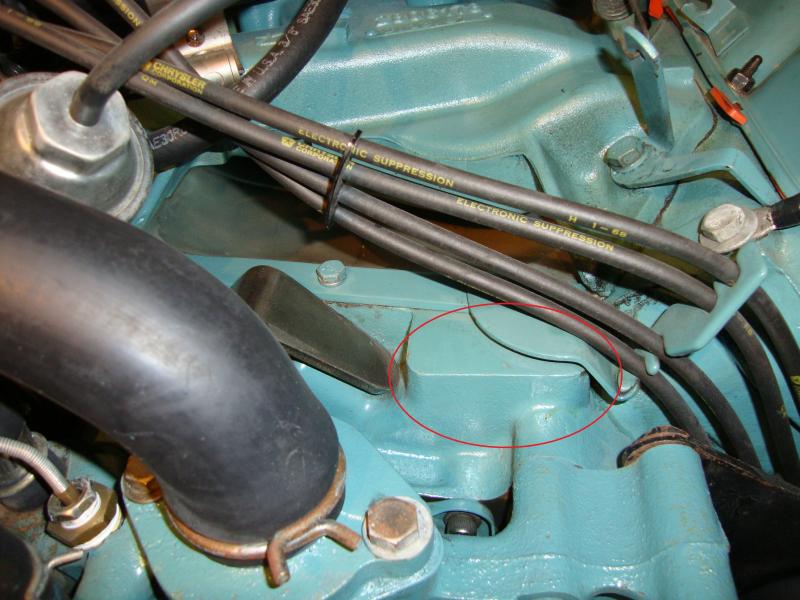

here's a pic of said 440cid pad...

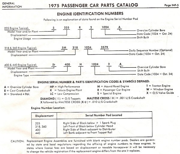

It says 5T440TE Also what is the horse power and torque of these engines stock?
The pictures answers the first part. The first T indicates Trenton engine plant. The second T indicates a truck engine. Is there a VIN stamped on the passenger's side of the block?
The second part: depends on the application. Does it matter at this point if you plan on rebuilding it?
