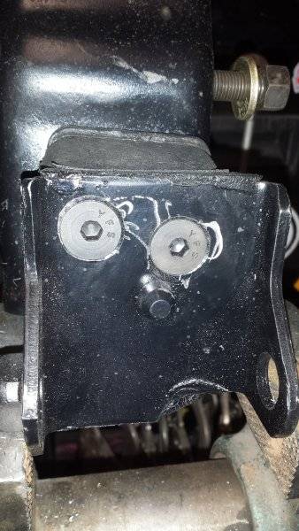

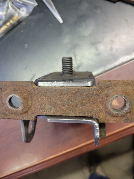

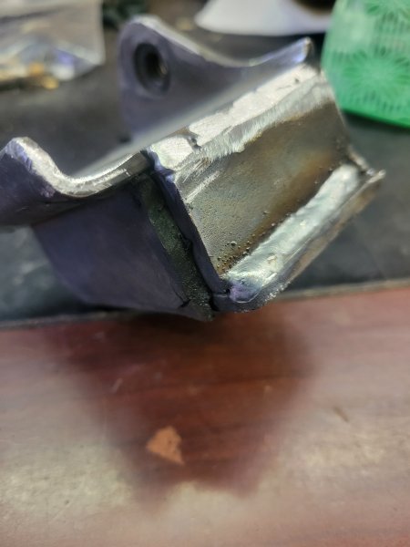

There not to bad,reusable lol.spent the morning pulling them out and Mancini went in.hope they can handle this torque monster.glad I had a chain on the left side.
What brand were they, how old are they and what sort of beast mangled them like that?

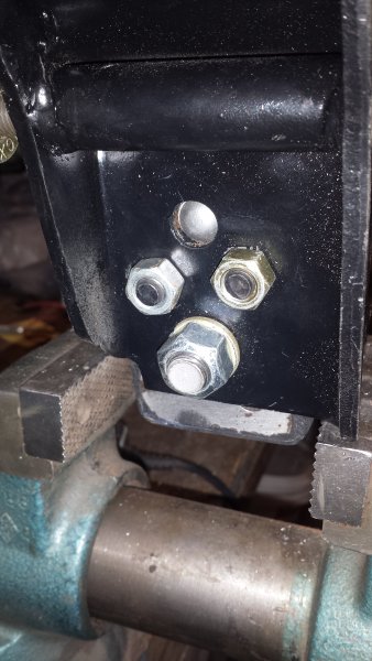

A solid mount on Drivers side and a rubber one on the Passenger side works great and never have to see a mount look like that again.

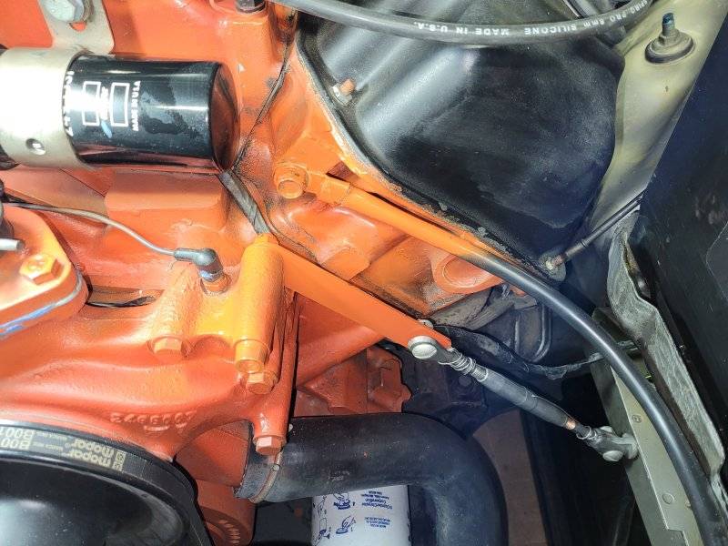

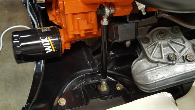

Yikes! Destroyed those. I like the turnbuckle idea. When I mounted mine I bolted the steel pieces together with a countersunk grade 5 bolt and nut. So far so good.
Will do next time

Replace the damaged rubber with a block of aluminum and a stud. Worked on our turbo car with a transbrake running mid 9's for years
