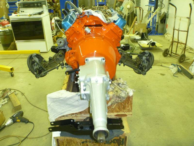

No problems painting two of mine with single stage urethane over epoxy primer. AkzoNobel U-Tech was the brand I used for both, one in red and one in orange.

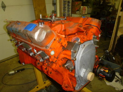

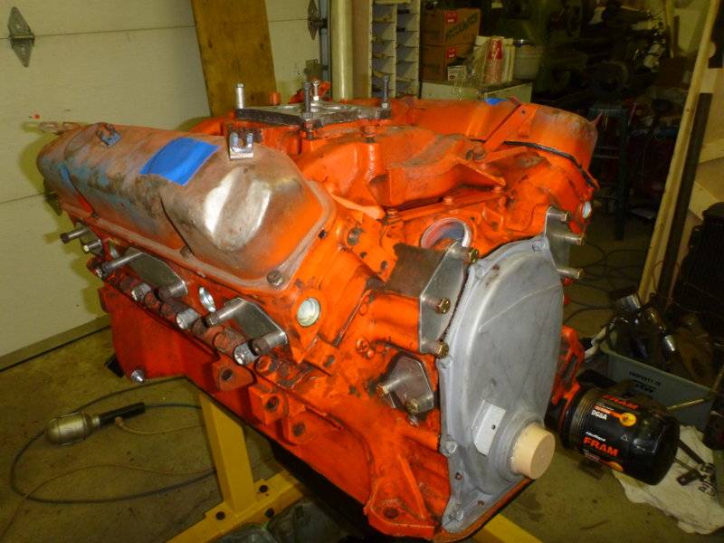

PPG Delfleet after glass media blast. Took longer to cork every port than prep and paint!

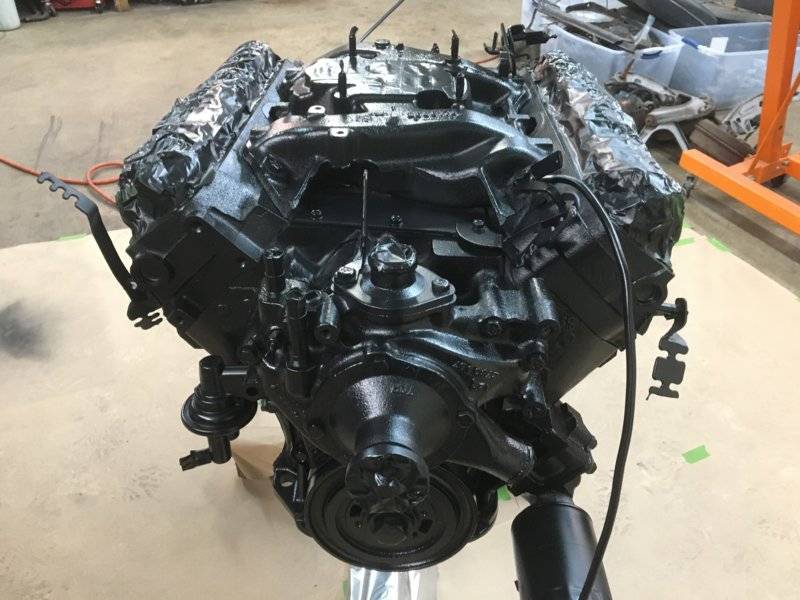

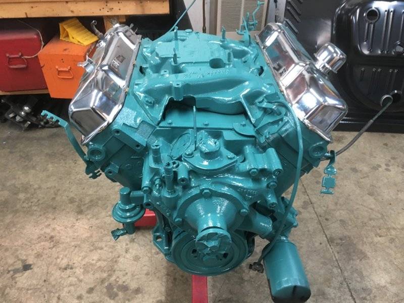

We always use car body urethane. Have some that have been painted 20 years. The race motor even has Bondo in the ends of the heads to fill the INDY logo.

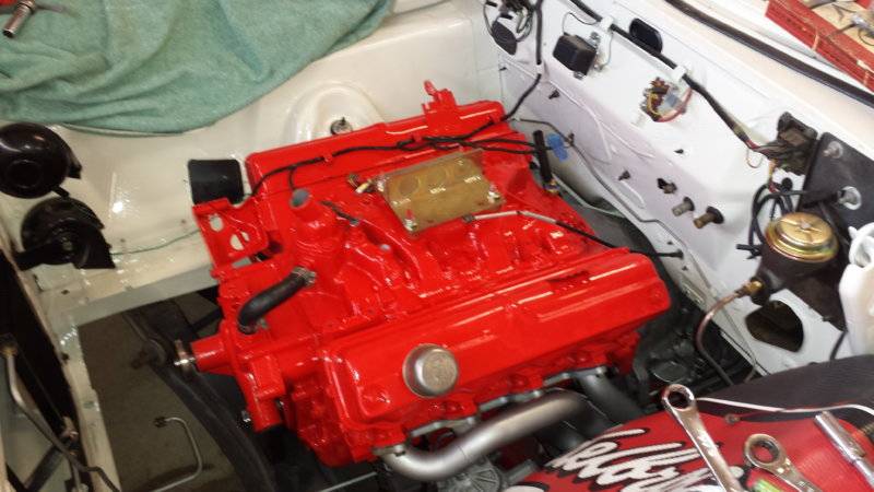

No problems painting two of mine with single stage urethane over epoxy primer. AkzoNobel U-Tech was the brand I used for both, one in red and one in orange.View attachment 701995

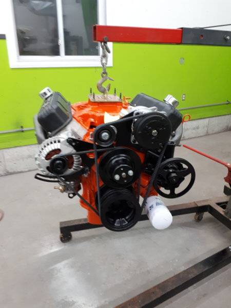

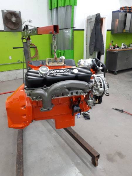

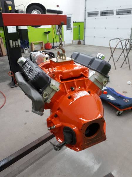

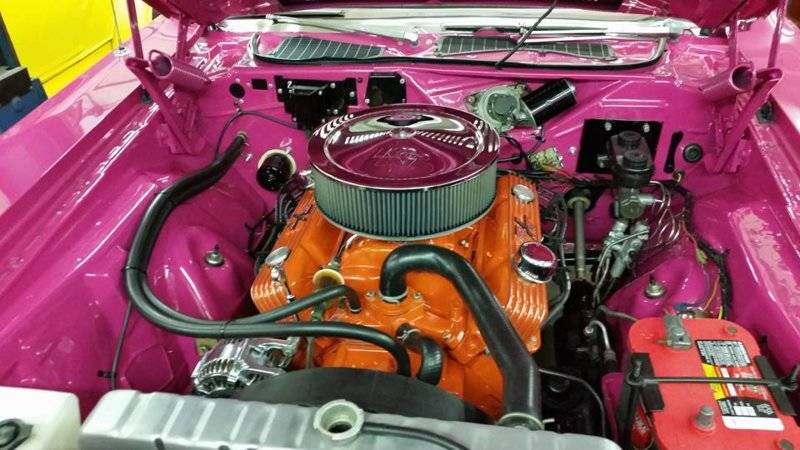

Thanks to all that responded. I gave it a really good cleaning, lightly sealed with epoxy and then urethane. I have it mostly assembled now
