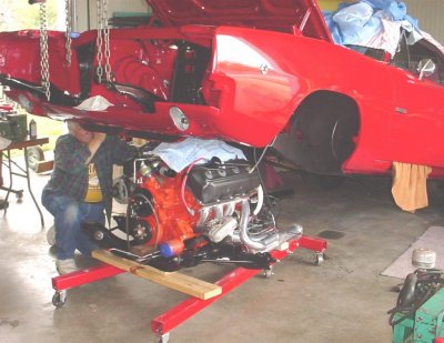

This is the only way I know how to accomplish that....

I know that i could not install my engine with the headers on like above...Lots of luck!!!!
Petty Blue 67 gtx
You'll never be able to do it from the top.... Keeping the engine complete is going to have to be done like Bluefury said.... Lots of luck!! Take lots of pix so we can see how you did it.

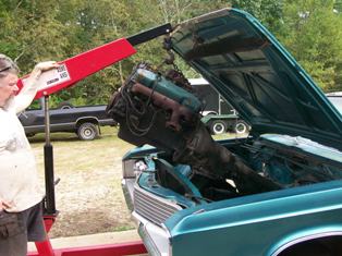

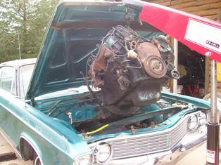

We pulled my engine and tranny all in one shot from the donor car without even taking the hood off.

CTm god pictures. Just like i was thinking.

left the left header on and let the right hang loos. pulled the engine and trans together. Worked OKEY. Would have been better without the right header gone. Well you learn all day long.:laughing11:
