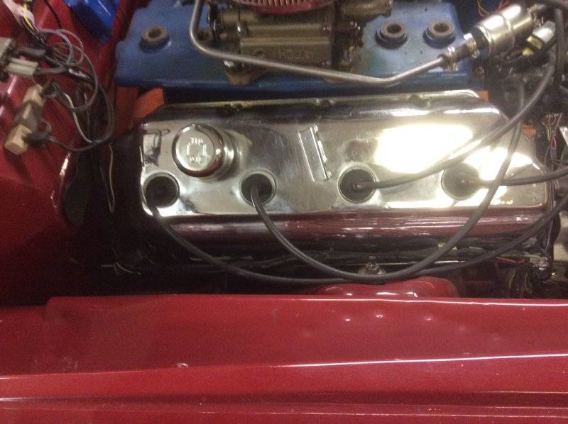

Could you use a 66 K member? I think they bolt in, racers use to do that. Wait until other people confirm this. I made a pattern of 66 Hemi K member mounts. Cut off mount on my 65 K member. Dropped engine in and positioned engine where I wanted it, tight fit. Tack welded in place. Removed engine and welded the mounts solidly in place. Xram 3/4" from voltage reg.
