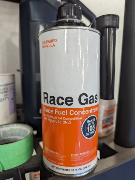

Hey all. Thank you so much for the replies. I will go out right now and inspect the carb bowls and floats. I'm also going to pull the spark plugs and check everything. I was at the engine builder yesterday, and even though here in my province we cannot buy ethanol free fuel at the pump, they recommend an octane boost that their customers are using to help the burn. I have enough for 2 full tanks of fuel. I'll try that and see what happens, along with checking the other things mentioned. I'll reply with anything I find and any changes the 105 octane additive make. Thanks again all.

Sorry, I forgot to add this to my last response. Last year right before the driving season ended, I installed a 1/2" thick phenolic spacer in a recommendation from a local carburetor guy that many people speak highly of. I'm supposed to bring my car to him, but between him living out of town, and my work schedule, I haven't made the time. This drastically cut down the temperature sinking up to the carb from the intake and heads, which are also aluminum. I actually just got back from a 90 minute drive a few minutes ago. I added the 105 octane boost and filled the tank to full with 91. I also found that the nuts holding the carb to the intake(with the spacer and gasket in between)were not tight. I should have checked those first. They were really quite loose. Could have been pulling air in. Also, my PCV was not seated properly on the valve cover, and I got it sealed up properly. Overall the car ran fine while driving. Good throttle response, and no bogging at take off. I still have to figure out why engine won't high idle at start up. I had it set to high idle at about 850-900, and then regular idle at 650, but it won't high idle at all, and even regular when hot sits at 500-550. Anyway, I'll keep on it.
