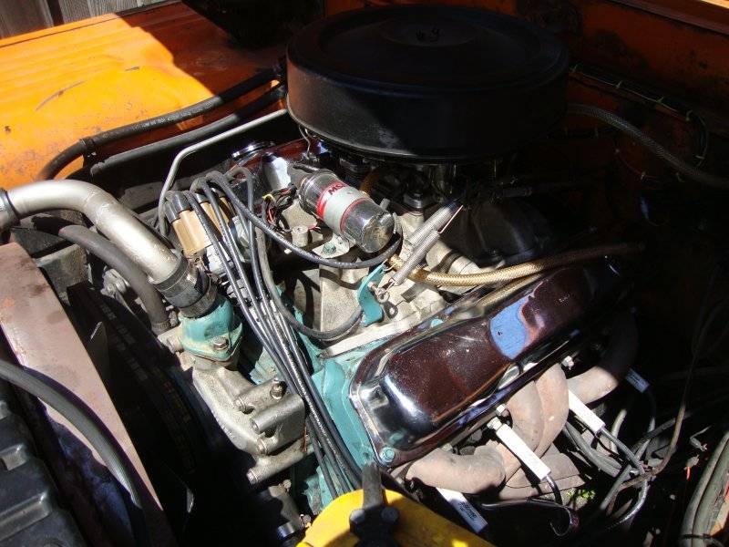

A 1958 International V8 will run on straight alcohol. A 1978 International will run on straight alcohol. I have run e85 to save money with no adjustments to the carb.
They built them all to run on LP gas, so ethanol blends don't hurt valves and I've never had an issue with carb parts dissolving. IH has always had top quality stuff.

the carb can not just rest atop the intake that transfers heat . so i've been using carb spacers made up of multi gasket thin spacer and so on the stack , this will keep the carb cooler , and the most important item is to block off the exhaust heat transfer ports m if you have them in the heads . intake gaskets are out there to block those ports . this is what it took to keep the fuel from boiling in the bowls and vaporing down the carb and intake , and it might need retuning and new gaskets and pump to handle the crappy new fuel . been dealing with this type fuel in calif for years now . and even with a hot cam this afb carbs does just fine , spring , summer , fall and winter . but an electric choke is needed , well a choke is needed . these two emgines have carter afb type carbs .
