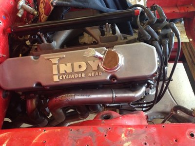

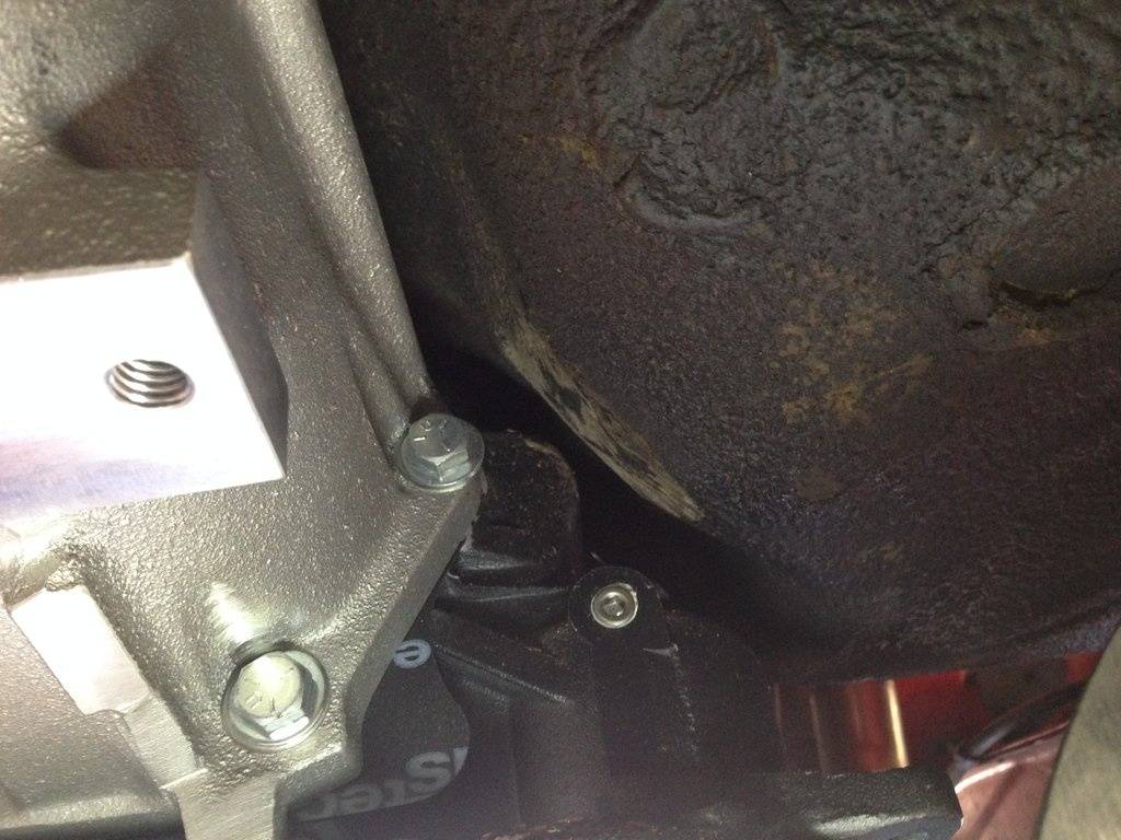

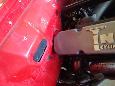

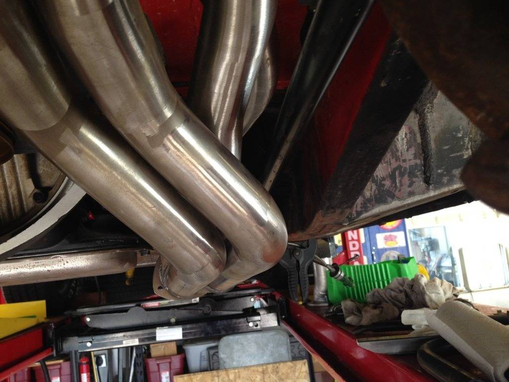

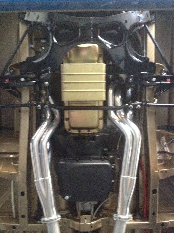

The newer k's do move the engine/trans back. Its a little tight above the case where the piston bosses are but doable. I bumped mine around to gain a little more clearance, especially since I'm running a Gear Vendors on the end. You do have to address the trans x-member. No clearance issues, for me, on header to t-bars/frame/floor/ps box. I know of a guy here in town that has done that swap on 3 of his cars with no issues but since I'm using an Indy aluminum block with hemi mount bosses and Schumacher mounts, I needed to verify and not assume.
IMG_1513.JPG IMG_1514.JPG IMG_1516.JPG IMG_1519.JPG IMG_1520.JPG IMG_1541.JPG

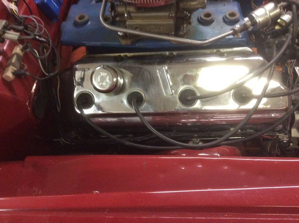

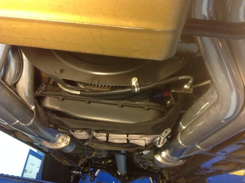

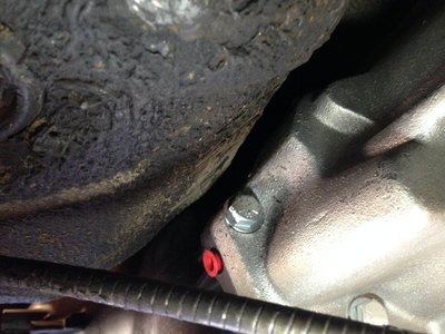

64 Plymouth Belvedere with a 69 RR K frame. Minor mods required to the trans mount. I went with the single stud mount. No other mods required. The engine does sit up about 3/4" more, but a 727 fits in the trans tunnel ok (trans blanket gets very snug though). Right side valve cover is close to the firewall too but there's still room to get it off. The trans filler tube gets close but still accessible.
thats great , mine getting my parts together for the swap out , has anyone done it with an a833 4spd and 143 flywheel assembly . woundering about the paddles and clutch linkage . not crazy about juice clutch set ups . i'd rather have linked .
Wish I would have seen that picture earlier, I've been worried about the header clearance at the crossmember, just got back from the muffler shop about 20 min. ago, was glad that it worked out, old car is now nice and quiet, can you say "stealth" the ttis are tight!! Dave.

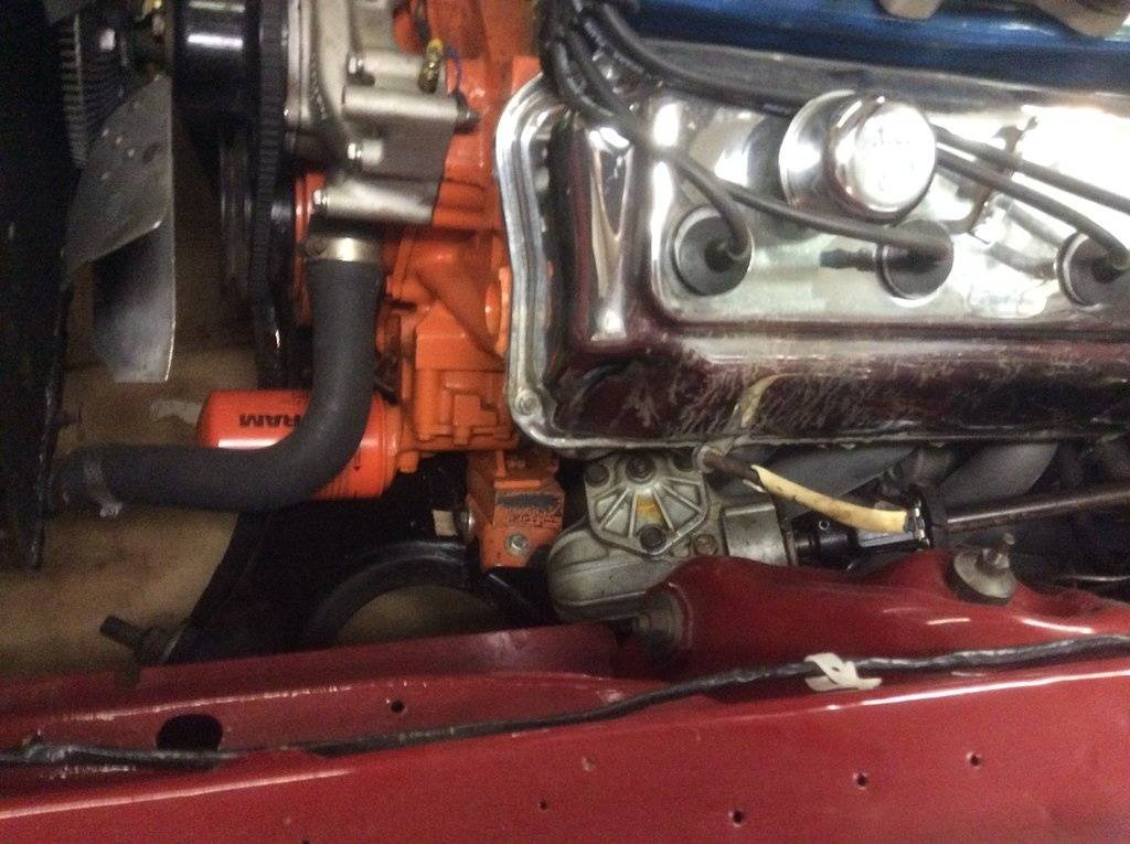

My swap I traced the mounts on a 66 Hemi k member. Took 1/8" flat stock cut them out and mocked up motor with intake. The intake is 5/8" from firewall. Read I this site racers used later K frames to set back engine but had to modify pass side F/W. I had to redrill holes for outer clutch pivot. If you make a new bracket on bellhousing you could avoid it. Judging from Malex's pic mine is forward !/2" to 3/4" from his. I have a blowshield tunnel modified BFH and flatten seam. Shifter hole made myself.
My swap I traced the mounts on a 66 Hemi k member. Took 1/8" flat stock cut them out and mocked up motor with intake. The intake is 5/8" from firewall. Read I this site racers used later K frames to set back engine but had to modify pass side F/W. I had to redrill holes for outer clutch pivot. If you make a new bracket on bellhousing you could avoid it. Judging from Malex's pic mine is forward !/2" to 3/4" from his. I have a blowshield tunnel modified BFH and flatten seam. Shifter hole made myself.View attachment 440334 View attachment 440335
There's nothing that looks better than a Hemi under the hood.

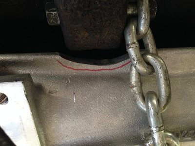

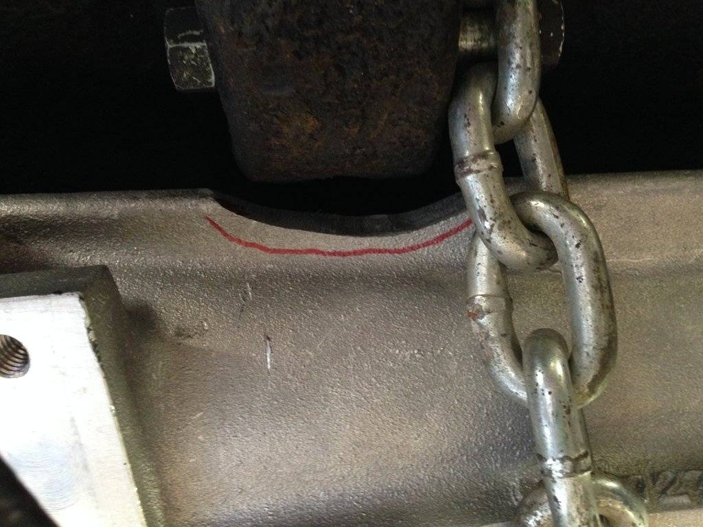

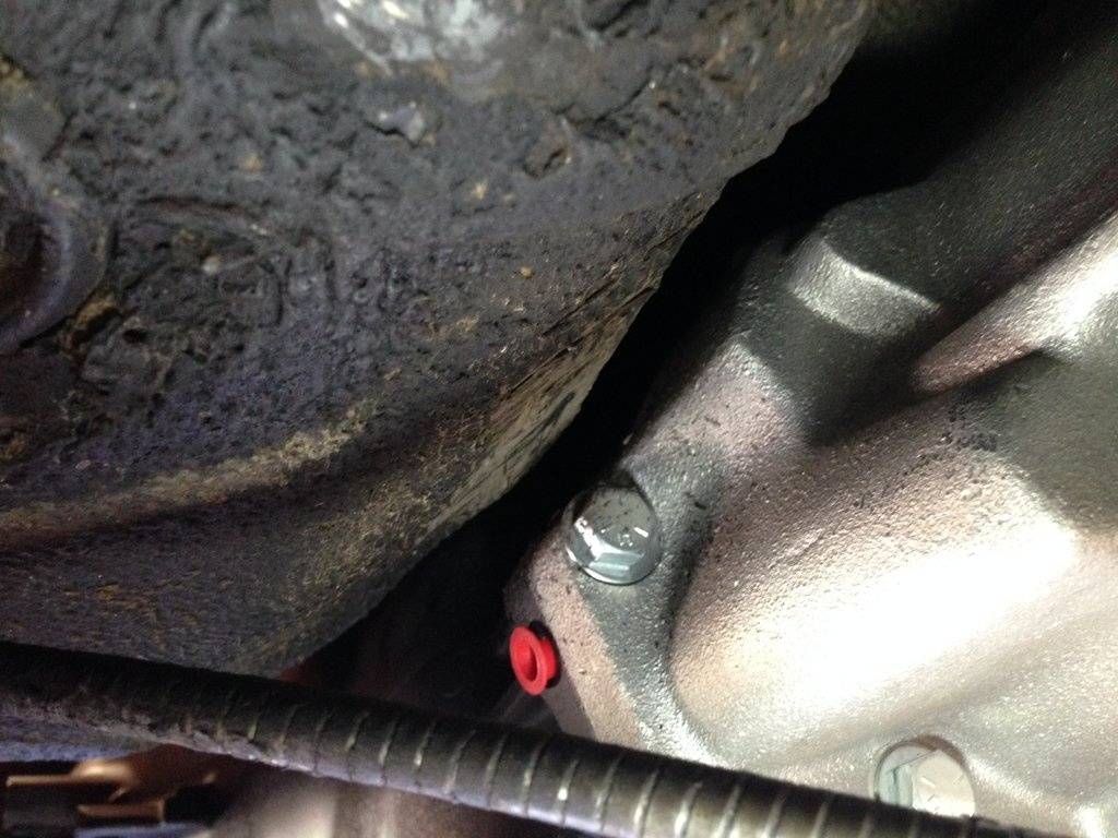

For those that run the TTI headers, torqueflite and a cable shift stick, you know how hard it is to keep the cable off the headers. Pretty much a matter of when, not if, the cable burns.. It happened to me on the weekend at the track. I tried a new cable route today though and I believe this will work. Have a look.
The cable now loops around the transmission, nowhere near a header tube to burn.
