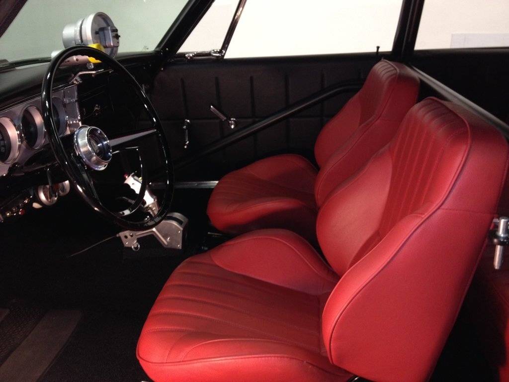

It's a Hurst Pistol Grip Quarter stick, The cable and bracket is all part of the pkge. The cable had enough length that it could go around the right side of the trans. When I had the cable feeding past the header it had to be tied to the starter and bolted to the back of the head, and it still got burnt from the header. Here's a picture of the shifter in the car.
thanks , i'm running a similar package in my 63 sf mw auto .and thanks for that info for my auto car . but i'm doing another 63 fury with a mw and an a833 4spd which i'm using the later k member in .
