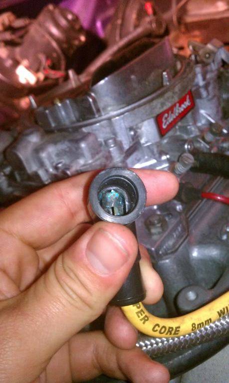

Ok, well I went back and re-checked what I had thought I already checked and you guys told me to check again anyway. I checked the spark plug wire for cylinder #7 that kept fouling and had continuity from one end to another no matter how it was tugged. So, I checked the connector on the plug side, bright and shiny new. Then I checked the connector on the distributor side and this is what I saw;
Here's some of the corroded gunk where it connects on the distributor;
Not only was it badly scorched and corroded, but it appears as though the shop cut the wire a little short and instead of replacing it, tried to make it work. I should have taken a picture of how it was before, but this is after cleaning and reseating, the best I could get it. Since it's so far back in the boot, it took me a lot of cussing and a set of snub nose pliers to get this thing on like this. I can now see why it would have only made an intermittent connection before. The section that engine started to really get up and go, it'd shake that plug loose since the rubber boot was putting so much pressure on it in the wrong direction.
I should be able to really test it tomorrow on the way to the shop. Thoughts? Pending the test drive, do you think that this would explain it, or do you think I may have just found another issue? Thanks again.
Good find that would cause the vibration and loss of power!
Im pretty sure there should be a brass terminal crimped to the wire inside that boot that locks into the dis cap.
I would check all ur terminals make sure no others look like that.
It may be time for a new set of wires!
It used to be brass, and actually all of the others on every other wire is absolutely bright and shiny brand new brass. That one terminal is the only one that's like that.
Good work! With the brass terminal that far up the boot it's possible it was only getting intermittent spark jumping to it (or none at all) and that could cause a misfire. As mentioned, check them all and make sure the carbon conductor is folded over the end of the wire under the brass clip.
