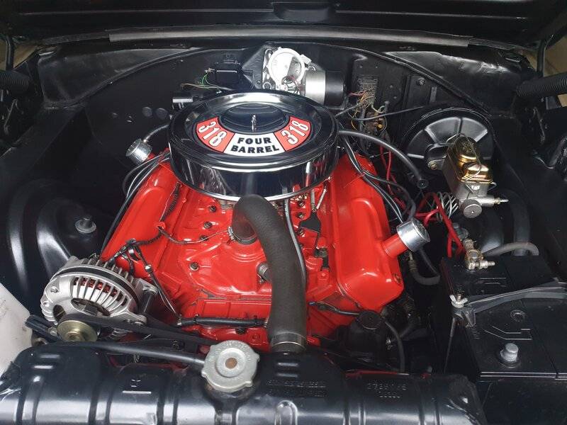

Awesome picture of an actual 4 barrel poly
I have the 318 poly 2 barrel in my 63 Belvedere but have been looking for the 4 barrel intake and evidently they are rare.
I see plenty of dual 4 barrel intakes but that is a bit extreme but cool at the same time.
