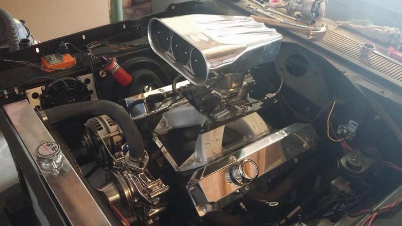

i built my own.just bought replacement terminals for the plugs.little crimp,some solder,and heat shrink.took a few hours,but works great.as long as your connectors are not melted you can rebuild them. 10411292_237489503112653_6391885681296785854_n.jpg
i built my own.just bought replacement terminals for the plugs.little crimp,some solder,and heat shrink.took a few hours,but works great.as long as your connectors are not melted you can rebuild them.View attachment 203528
Awesome engine sir! My harness is original and brittle as hell, so I need the whole enchilada as far as the Engine harness goes. Lights are just fine, but everything else south of the bulkhead for the motor is crispy.
thanx.i mean you can rebuild the harness including new connectors at the bulkhead.the male ends inside the plug are removable and replaceable.
