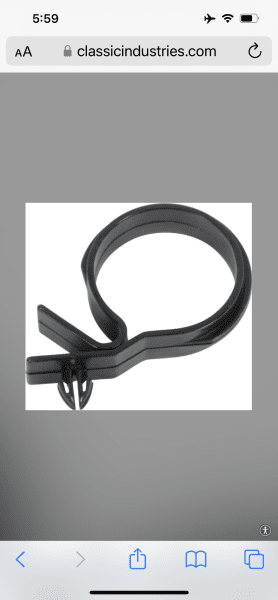

Anyone know the proper placement of each of the straps in the kit pictured? I commonly see one of the large circular black ones just forward of the RH shock tower but I haven’t seen locations for the other two. Were the use of all or some of these dependent on options such as air grabber, air conditioning etc.. Thanks for the help.

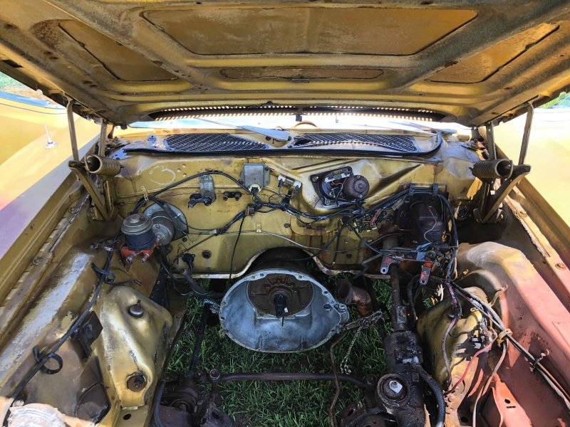

The other two locations are just below the ballast, and the wiper motor. You can see them in this pic of my car before I striped the engine compartment.

The long one goes on the right inner fender just above the shock tower, you can see it in the pic above. It keeps the heater hoses away from the engine. The short one I am not sure of. Never found one like it on my car, maybe battery cable?
I believe you are correct on the two black ones, they go across the recess that is behind the battery
