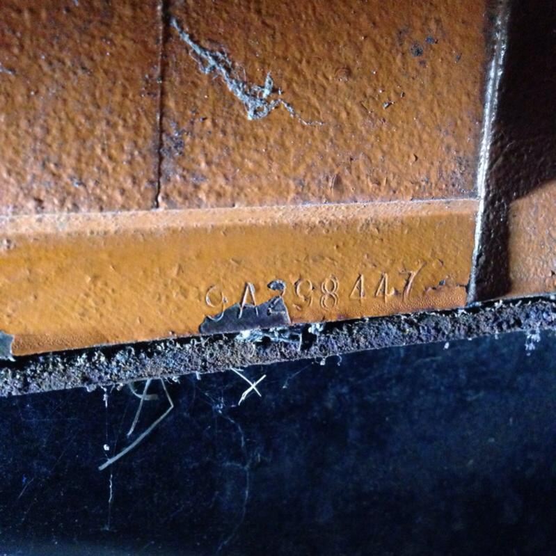

Can anyone tell me what this motor is out of?
These are the numbers by the oil pan passenger side
9A298447
Posted via Topify using iPhone/iPad
Could it be out of a dart?
No. Lynch Road built B bodies in '69. I don't know what the displacement is but it's out of a Belvedere based car such as a Satellite-Road Runner-GTX
Meaning it's from a car without A/C.
That leaves us a Belvedere-Satellite-Sports Satellite or Road Runner four speed car (Is the crank still there? Is it drilled for a four speed?)
or Road Runner with automatic transmission.
