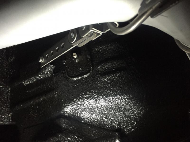

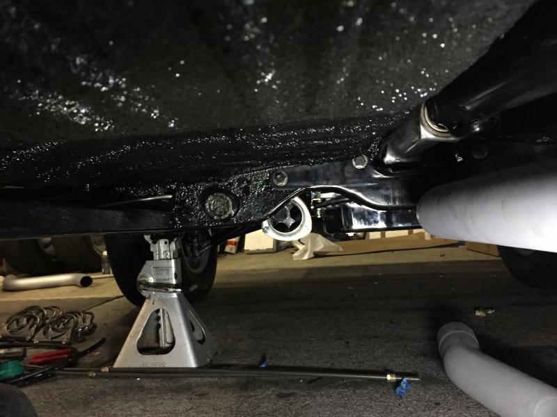

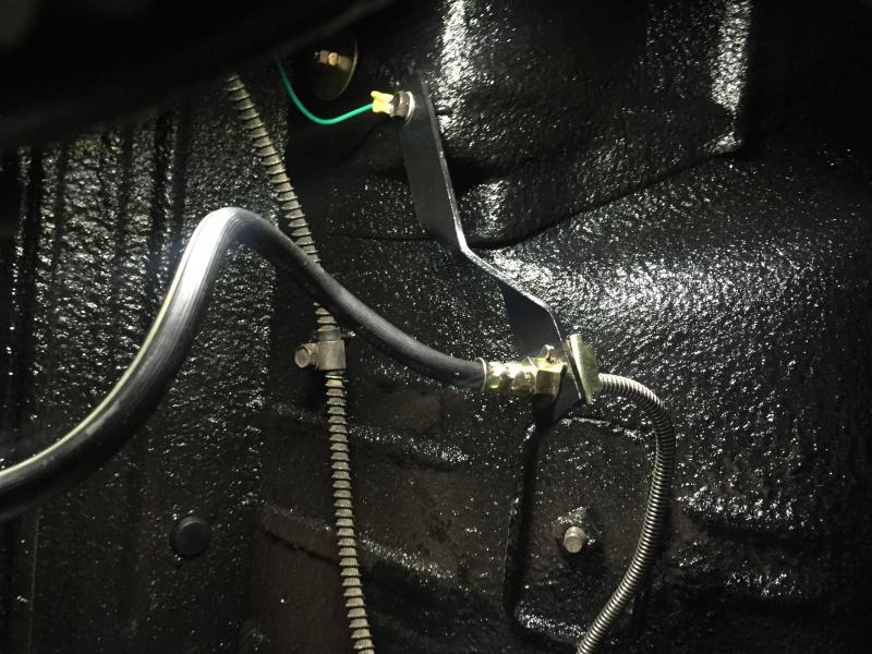

Second is mount points for the exhaust hangers. I've got a summit 3" exhaust with the hangers included. The car didn't come with any exhaust, so I'm flying blind. If you see the pics, it looks like I have a hanger point on the passengers side but none for the drivers, this is behind the back seat.

Thanks for the reply mate, i really didn't want to cut and weld the manifolds, or the outlet flanges to be honest. So what I;ve don't is cut about an inch of the outlet flange that bolts to the headers, which allowed it to slip on further, then 'clearance' the pipe where it was touching the crossmember.
Came together pretty nicely. I'm not trying to eek out ever last HP, so a dimple in the exhaust doesn't stress me too much.
As for the mounting, I found a spot to put two u-nuts in near the ned of the chassis rails, and left the drives side without the mid way hanger for the moment. Seam really stable so that should do the job. If not, I might make a bracket and hand it from one of the pre-tapped holes.
