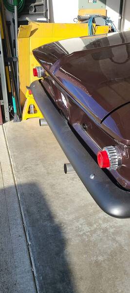

So my car, a 62 Savoy is finished other than a few minor things, trunk latch needs adjustment, fuel guage and speedo not working right, but everything is good, except I'm getting a Lot of Exhaust Fumes inside. If all the windows are closed it's ok. But the only "AC" l have is open windows. I went about 20 miles down the freeway today to get my car weighed for insurance purposes at about 3400 rpm and the fumes were pretty bad. My tailpipes exit the back by a good margin. Any thoughts ?

Don't think anythings coming through the trunk firewall. Solid piece of sheet metal and chalked, rubberized sound deadener and carpet with all body plugs in. I took it into my body/paint guy to look at the trunk latch and he has me booked for the 17th. He thought that if nothing comes in with the windows closed, and fumes come in when the windows are open, there is a negative pressure building up in the cabin. Plus l don't have a heater or floor vents to give a positive pressure inside. I think it's something like what "Dual Fours" was saying about his Dad and the "Chewing Tobacco "
