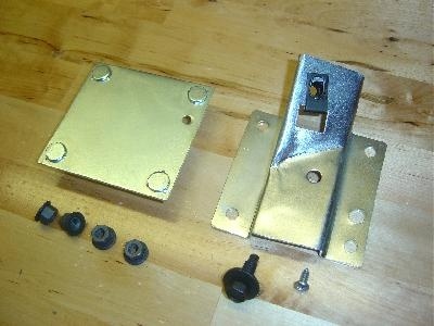

anyone know if the 70s charger exhaust bracket is compatible with 71?
id be replacing both pieces seems to look very similar unless dimensions are that much different
the bracket you listed i beleive attaches to the frame rail.
the bracket im showing attaches directly to the back of the seat. my 71 has one
i ordered it anyways i will get it to fit somehow haha
i thought id update people to let them know this worked on my 71 charger as well
welded it on yesterday and didnt need to be modified. holes lined up with the old plate.
