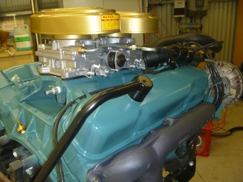

I chose to go the more expensive but proven route of ceramic coating. It's bullet proof and as the coating is inside and out and an insulator, the manifolds radiate far less heat under the bonnet.

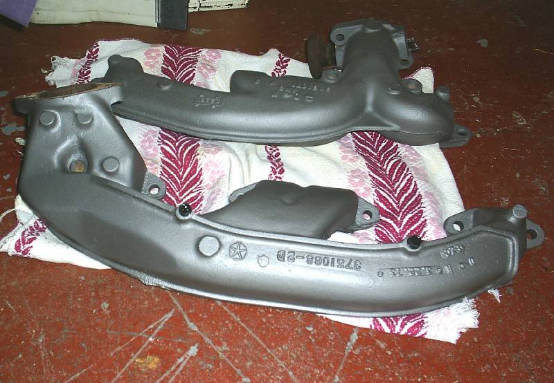

I used Eastwood's manifold paint 4 years ago and they still look like new. I personally don't like the rusty look.

Those look sweet. Looking at your pic reminded me, I ordered the original plug wire holders anyone have any suggestions for wher to order the right lenth plugwires?

Engine ain't a museum piece, it's in and running well. In fact, going for a cruise in about 10 minutes!
With ceramic coating, the reduction in under bonnet heat is quite noticeable, and considering the problems I had previously with heat soak and vapour lock, was worth the admission price alone!
I used POR-15 exhaust manifold paint. Sandblasted manifolds, 1 coat, wait 24 hours 2nd coat. Both coats applied with a brush. No problems and looks very good.
