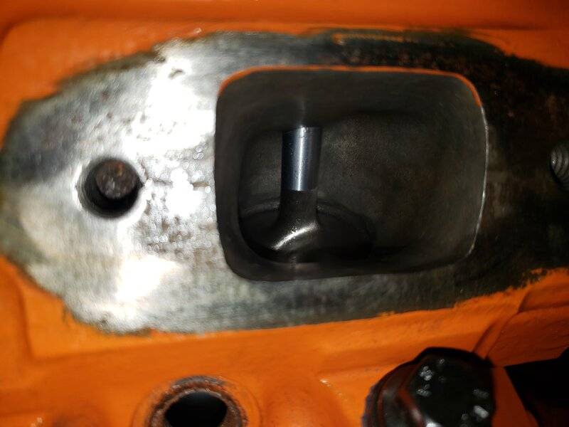

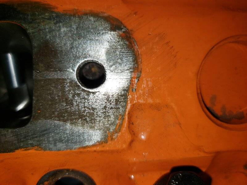

Looks like all exhaust studs are in water jackets on my 906 heads. Maybe other cast numbers differ?? I'm not sure.... i can post picks as I currently have them all out. 1968 440
So I ran out and took picks, the end studs you can clearly see back in the heads with a light. The insides ones appear to have iron behind them , but do not. If I take my air gun I can push air no problem threw, they have opening access on the tops of the holes for the most part. I tried to capture it in the photo but pretty difficult to see. Surry I tried. # 5 & 7 exh ports below
