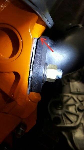

I have had an issue since day one with this. The exhaust manifold passenger side is constantly springing a leak. We tried gaskets even though I am aware they didn't have gaskets from the factory, they blew out. So I had the manifold plained and reinstalled, that worked for about 4-5 years but it is back. I can't do this myself so I have to take it somewhere and the fellow who looked at it recently says we should try another gasket, this time a hi temp racing gasket. I have a feeling I know what the outcome will be but what other options do I have. (no - headers).
Anyone been though this nonsense?

Look at the mating surface on the head. I was installing Doug's headers on a set of 452 heads and noticed a ridge. I had to grind (taper) the flange on the headers to compensate. (Just throwing this out there)

You have been paying so much attention to the manifold, but how is the surface on the cylinder head. Clean it good and try seeing if the surface is true.
