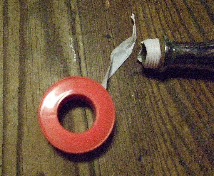

Thanks Gary! Yes, PTFE (also incorrectly known as teflon) tape, commonly used by plummers (see Wikipedia pic below). Can be very effective but when the offending stud was removed there wasnt much evidence that any tape had been there :eusa_think:
