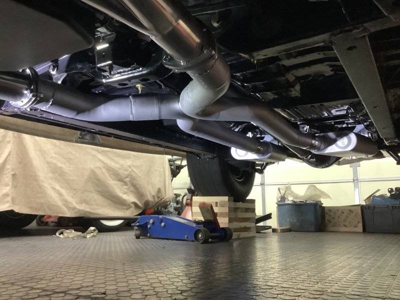

Even with 3” pipes there’s an air gap of 2” or more between the floor pan and the exhaust.
The rear hangers at the mufflers will pretty much dictate the rear section and the header or down pipes will have the front.

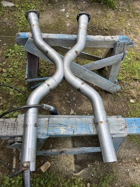

What length did you cut your 2x4's for your wheel stands? I've been meaning to get some made.
That exhaust looks very clean. Nice install!
12” wide by 20” long, the wheel cribs made doing the exhaust much easier.
