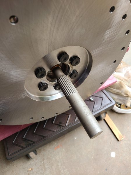

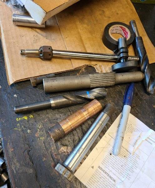

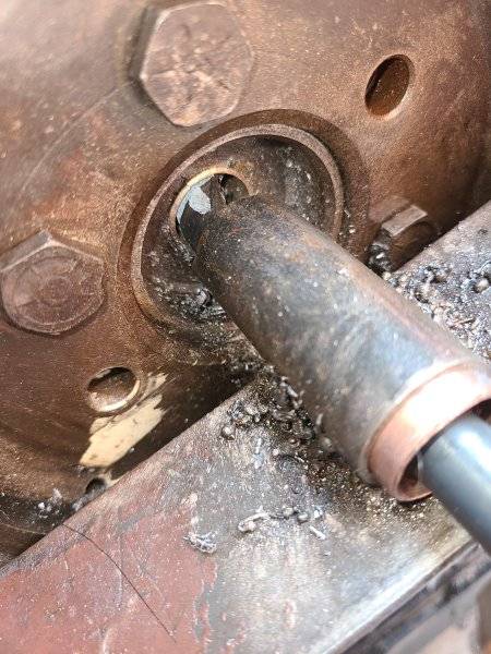

I made fixture and using the flywheel for a guide I drilled out this 383 forged crank for the 833 input shaft in situ since the engine didn't need anything else.
I have done this on cast cranks/cut shafts before and used a register bearing. (Glyptal or red varnish. No leaks so far)
Yes, the forged crank fought me.
The engine had an INCORRECT bushing in it. So that is what is in the picture. (Don't ask)
But I was NOT going to cut this new input shaft.
20240616_163303-3024x4032.jpgScreenshot_20240628_123057_Gallery-1080x1309.jpg20240724_091121-3024x4032.jpg

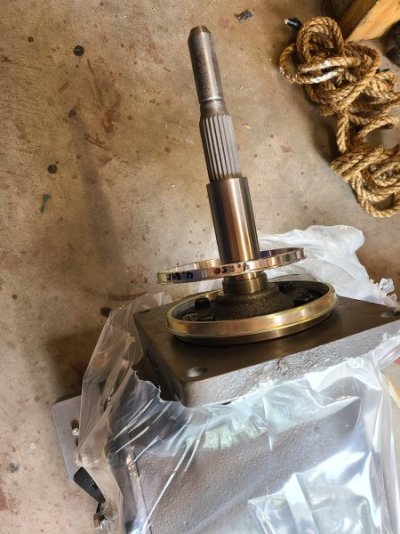

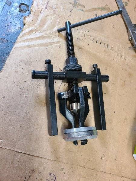

I found out that the AMERICAN bearing Brewers sells CAN be removed with this puller.
So will a bushing. Whoever designed this should get Noble prize.

I turned down a .940 bushing to .890 and it was a press fit so I'm pretty sure .885 is accurate.
Crank pilot bushing part#/size needed?
Post 8 there.
The reduced bushing only went in 3/8 inches which is too short and too thin for comfort.
It's not a space ship or airplane so close is good enough for me.
Might be a little off on total the depth given the drill point.
The clearance on the shaft is good though with the trans installed.

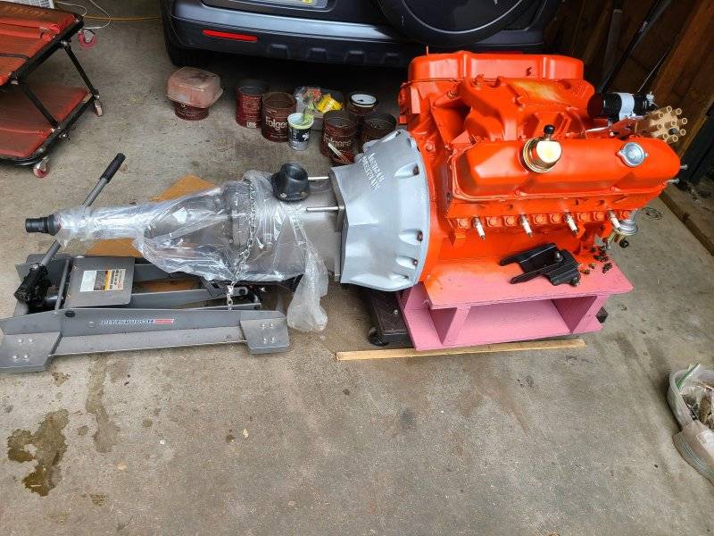

I bought the new housing during the lock down. Just grabbing things.
I have the original bell and engine but this is a completely new drivetrain.
APT didn't even have any. Found APT aluminum one at Summit.

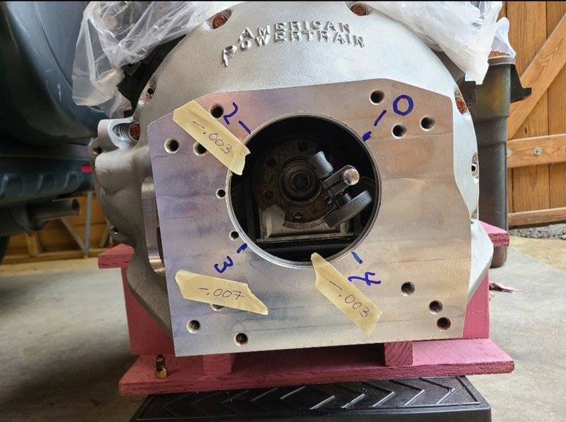

It came with to adaptors . One was undersize the other was oversize sloppy.
Had to call APT last month and have them look through a pile to buy the correct size since everyone is so into this runout thing now. (Yes.)

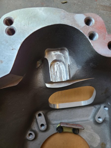

Check the starter clearance.
It had two milling cuts and I had to clean our extra material between them.

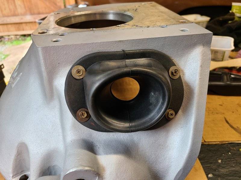

No body makes a boot for this animal.
But this Chrysler one works just perfect if you cut off the inner lip and use 8/X32 machine screws.
Leave the middle material.

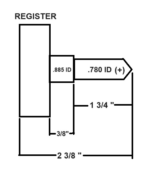

Look at the drawing.
That's what I have as near as I can describe it with what I have.
This was a 1969 forged crank engine originally an auto car.
Basically I'm asking if I can get a reamer to enlarge the .885 area up to the size to take a standard bushing.
That 3/8 deep area will also need to be extended into the .780 area with a hand reamer?
So can it be reamed up and into the .780 area? Maybe??
At this time there is necessarily a slight step between the areas. (.885 to .780 plus)
What brand and where did you buy this puller? I've been looking at getting one for quite awhile now, but they all seem to have terrible reviews.
the easiest way to remove a bushing is to fill the hole with grease Turn a piece of steel around.002 smaller than the hole pound the shaft into the hole The grease will push it out. You may have to add grease a couple of times. I have used this method a lot

I guess it would have been clearer to lay it out like this:
Reference the drawing.
An adjustable reamer needs to remove approximately the difference between .780 and .930 which I think is too much even though it is only a short length?
I COULD fudge that.
But on the original hole for the torque converter it needs to remove the difference of .885 and .930 which I think is again too much?
That original hole should be concentric to the crank from the factory machining I would think.
Based on what was found over on A bodies the unfinished holes do not seem to be uniform in size in all crank situations.
And from my limited experience as well.

Your biggest problem is holding everything concentric. Any reamer is only designed to take a few thousandths
out of a hole, not 0.030 or more. If you try to take too much stock out at once you'll screw the pooch. They make
drill jig bushings that hold a drill from walking sideways and to cut a hole true. They are hardened so the drill won't
chew them up. You could have someone at a machine shop make you up a round disc of steel that locates on the
Rabbet fit that the flywheel locates on the back of the crank and two concentric hole that will hold the drill jig bushing.
Make sure you put two holes in the disc to bolt it securely to the back of the crank using the flywheel bolts. Now you
can use a mag-base drill to drill the hole to size. You can have a twist drill sharpened to any size by a re-sharpening
service.

And really, unless you set this up in a machine and use a rigid tool like a boring bar or end mill, whatever you run in the existing hole will follow that hole.
I put a bushing in a drilled crank and still had quite a bit of runout.
The roller bearing is a much better solution.
