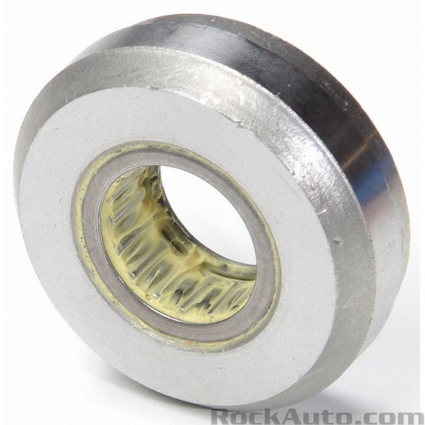

Easy way is to use a later pilot bearing.
NATIONAL FC69907 Clutch Pilot Bearing | Shop Now at RockAuto
If a bushing was in it...you will be able to work around this.
