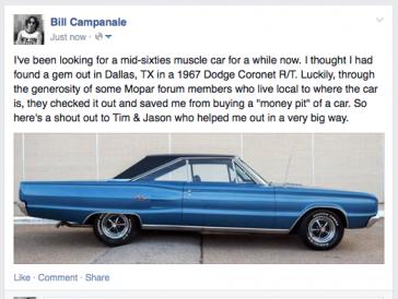

FWIW, boys. You're now famous! At least on my Facebook page! LOL
